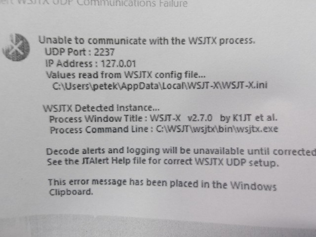

I am just trying to run log4om with wsitx and JT alert. All I want to do is get the confirmed Qso to be logged automatically into log4om. Does wsitx log the QSO in or does JT alert log it in to log4om? I have tried some of the instructions from page 90 and on in the manual and some of the windows that I'm seeing those not match up to the windows I have on the software? I keep getting the message that I have attached to this post and that's as far as I could get. Any help would be greatly appreciated!

Chose one or the other
Either JTAlert logging direct to the Log4OM database
or
WSJT logging to Log4OM via UDP
General UPD info is page 191 - 195 and specific external JT software integration pages 234 - 244 - have you updated the user guide lately?
