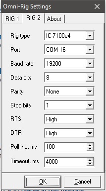

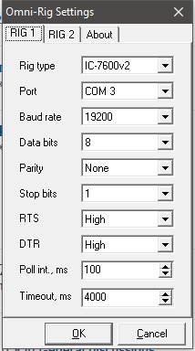

I have an IC7600 as rig 1 and IC7100 as rig 2 working 100% OK
My settings are shown beow but your com port and baud rate is probably different
2. Make sure you installed Omnirig to 'Run as an administrator'
3. Make sure that you installed Log4OM to 'Run as an administrator'
