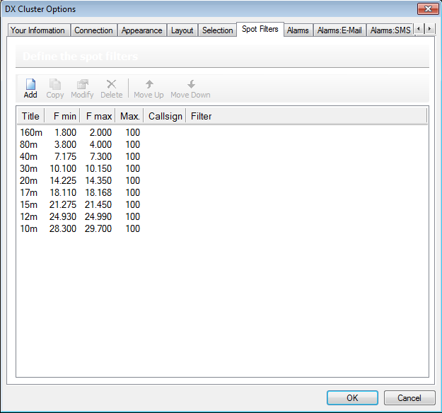

I've looked at VE7CC. It has band frequency ranges that you can enable/disable. but those ranges are predefined and cannot be modified.
HRD has a band range define screen.
