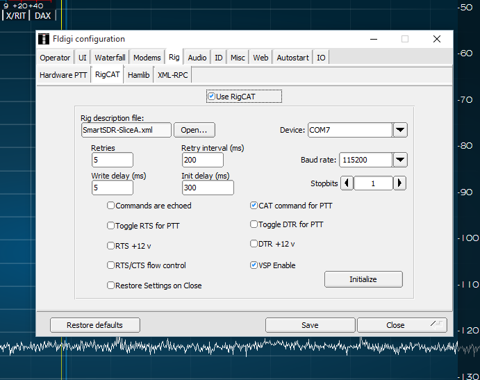

I have a very similar setup here. Only difference is I use the Flex 6700.
This is the setup I have in Fldigi. In SmartSDR CAT, I have setup a dedicated Virtual Serial Port on Com 7.
This way Fldigi is talking directly to the 6700 and not to Log4OM. My Log4OM is setup exactly as in the manual for inter-working with Fldigi. So when I save a QSO in Fldigi it gets automatically appended to the Log4OM log.
One thing to note is you have to start the SDR software before Fldigi.
Hope this helps?
73 Peter G3ZSS
