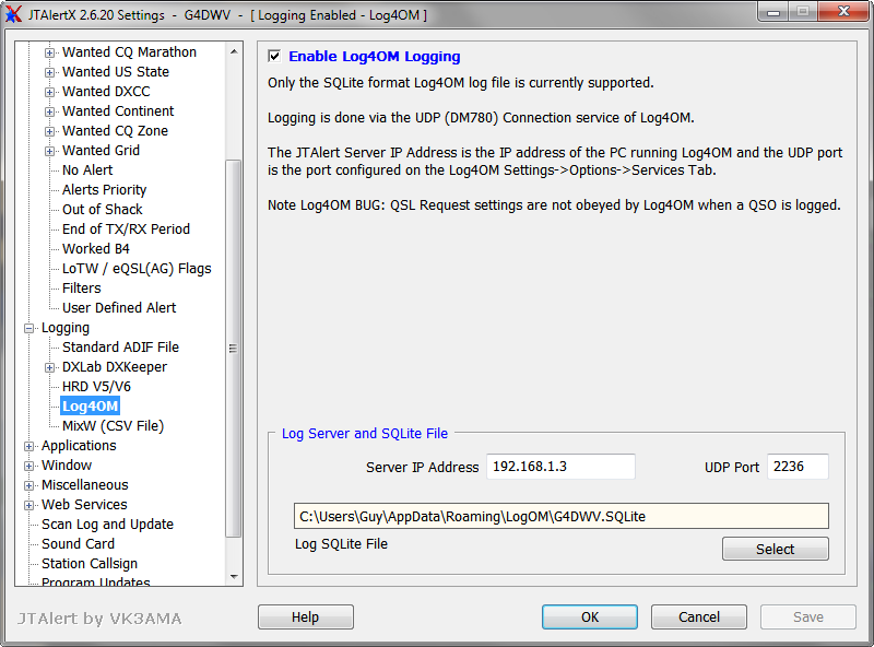

Daniele, things are configured for JTAlert to write directly to the Log4OM database. I have attached the JTAlert logging settings screenshot.
JTAlert logging settings.png (64.16 KiB) Viewed 5414 times
