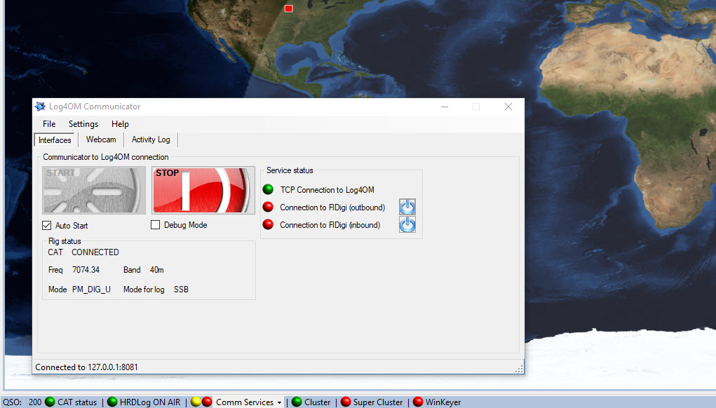

Isnt the comm services indicator at the bottom of Log4OM supposed to be green when TCP connection is green and working?
Re: Losing Communicator TCP connection JT Alert
Communicator is confirming that you are connected with one green LED and the message at bottom left of the window but the main window says otherwise?
Something wrong in the options regarding WCL or TCP or are you running it across a network?
Click where the red and yellow leds are and let us know the message

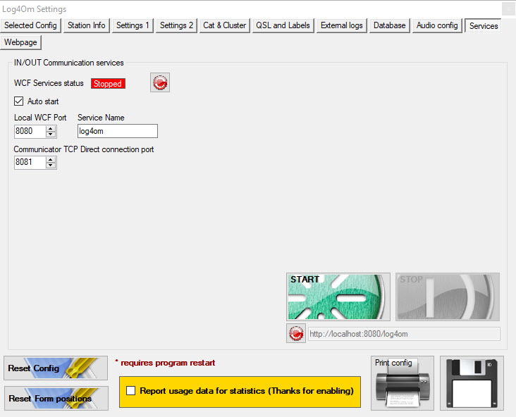

Screen shot of the Options/Services tab please
OK here you go. I have not changed anything in here but guessing something is not right.
Hit start button and retry logging via JTalert. ;) ;)
It wont start. WCF shows stopped still.
Rich
