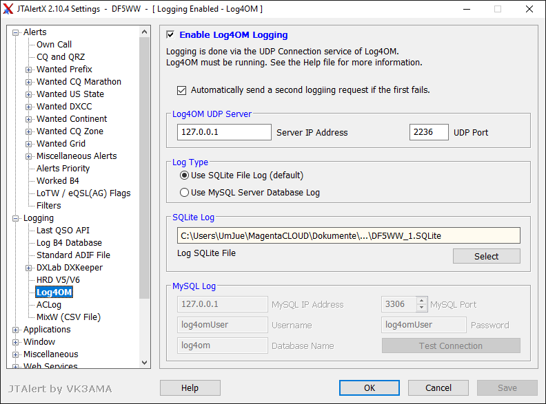

Are your JTAlert logging settings are the same then mine in the screenshot ?? Except the link to the SQlite database.

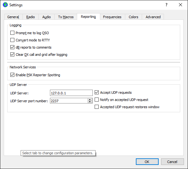

Are you have UDP enabled in your WSJT-X settings ??

Yes, that is correct. I have all the settings as you mentioned.

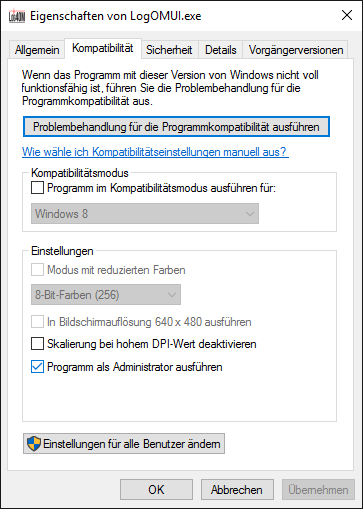

Think Terry means the way to go to your Log4OM (and WSJT-X) folders and do a right klick
on the Log4OMUI.exe and WSJT-X.exe. Now go to preferences and in the next window to
Kompatibility and check the Boxes for "Run as Administrator". Now you can save and after
the next startup the software will work under administrator privileges ...
Sorry, german Windows version ;) ;)
