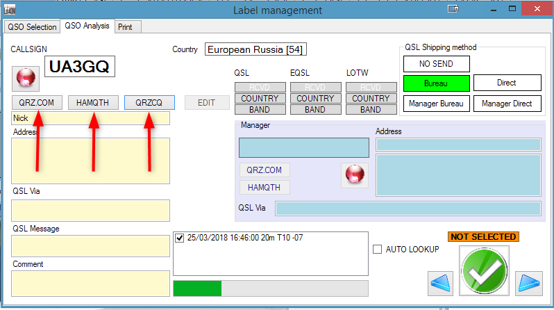

Attached is the screenshot as requested showing the buttons I have been clicking. Each one of them opens the site in my browser, on that amateur's page.
In your video, you click the red button* and mentioned that it will get the info from QRZ.com. I have been trying to configure the service that this red button uses.
*Clicking the red button does nothing here and i cannot get any details filled in from any online resource.

The three buttons that you are clicking are working correctly, they are supposed to open a browser at the selected sites, to fill the data you must click the red button as in the video and user guide.
If you get no data filled when clicking the red button I suspect that you have QRZ selected for lookups in the log4om options but don't have a paid subscription.
Why not sign up for HamQtH and try that?
Don't forget that not every station has it's details published

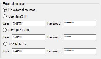

I am signed up for HamQTH and the login details are filled in in the external logs section of the settings. My QRZ.com settings section is empty.
I cannot see any other place to put the HamQTH settings so how can I get this facility to work?

Does the normalcall sign lookup work when you enter a call in the main qso input window?
Have you got the correct lookup selected in the Options/settings 1 menu
Re: Print preview
That second point of yours nailed it. I had that misconfigured. I had the external source set to "none". As everything until now was working FB, I did not suspect it.
73 de Guy G4DWV 4X1LT

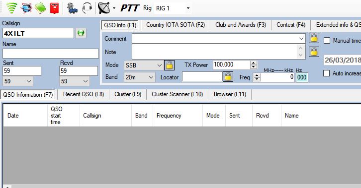

No answer for that because with lookup set to none and your call entered into my QSO input field it does not provide any data just empty fields as shown below:
Try a search of your log in the QSO manager and I expect you will find your call sign somewhere in the log
