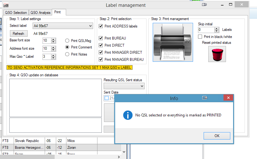

First, once I have printed a label for the QSO I cannot print a second one as the message dialogue that appears says that the QSO is not selected or is marked printed. I have attached a screen shot of this. AFAICT, having printed a label less than a minute ago, the QSO is selected, so how can I clear any "printed" flags? I have not been able to find any.

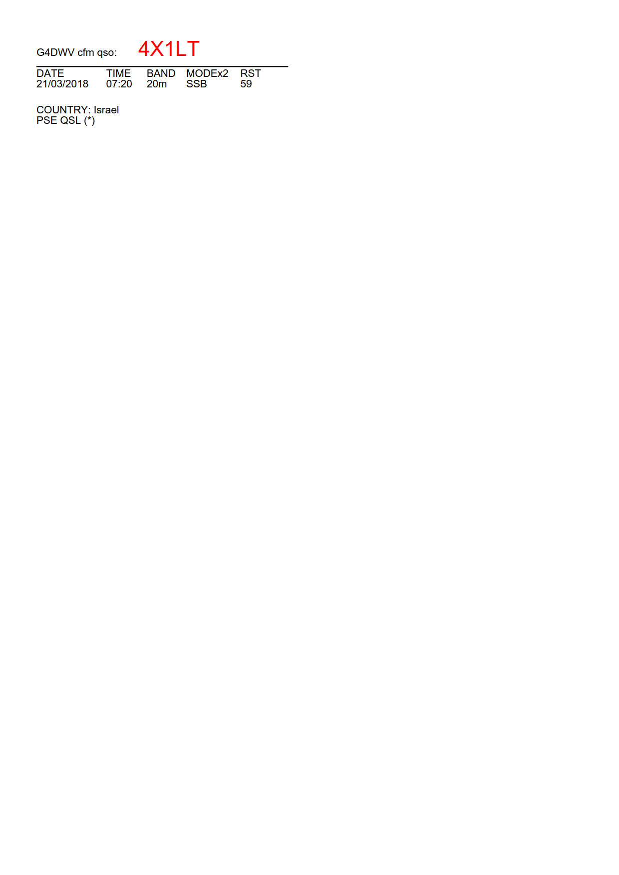

What is the best way to check what a label would look like once I have changed some settings in the label management > print tab? For example, in the attached example of a QSO to my Israeli call, I have actually checked the print comments box after having written some text in the comments box. I have ordered some 4 row, 2 column labels (99 x 67 mm). So did the comments not print because I have made the fonts too big?

G4DWV - Guy wrote: 21 Mar 2018, 07:49 First, once I have printed a label for the QSO I cannot print a second one as the message dialogue that appears says that the QSO is not selected or is marked printed. I have attached a screen shot of this. AFAICT, having printed a label less than a minute ago, the QSO is selected, so how can I clear any "printed" flags? I have not been able to find any.
Either click the red waste bin before closing the window which avoids marking the QSl as sent. Alternatively blank the QSL Sent Via and date sent fields and change the QSL sent status to N using the QSO archive manager
Use Test in the print layout
Either your template is wrong or the font is to large but from your screen shots I think it is the former.

It looks like the "test" function is not a test for font sizes etc, rather a test to check on the label layout. When I print a test label, it looks quite different to the labels produced by the test page.

Change the name to 'A1 my template' the list is in alphabetical order ascending or delete all of the other templates?G4DWV - Guy wrote: 21 Mar 2018, 16:15 How can I make "my" template the default? Progress is being made.
CorrectIt looks like the "test" function is not a test for font sizes etc, rather a test to check on the label layout. When I print a test label, it looks quite different to the labels produced by the test page.

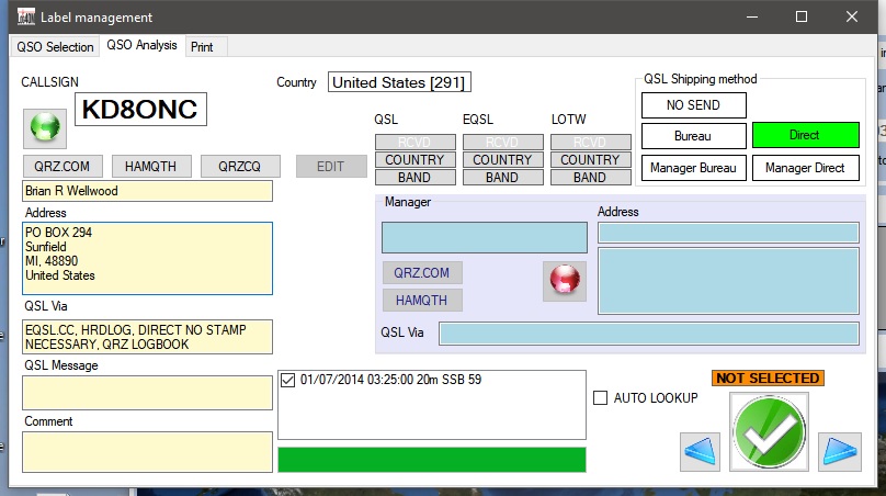

When getting fields filled in by using QRZ.com or similar, how does one configure which one is used when pressing the red circle in the QSO Analysis tab? Clicking the buttons under the callsign for QRZ.com etc, just opens that site in my browser.

By editing the data in this windowWhen getting fields filled in by using QRZ.com or similar, how does one configure which one is used when pressing the red circle in the QSO Analysis tab? Clicking the buttons under the callsign for QRZ.com etc, just opens that site in my browser.

How does one edit the data? The manual says to click on QRZ.COM or HAMQTH to update the operator and QSL manager information <snip>. All that happens here when I click on any of those buttons is that the site opens up in my default browser. From what you have said and going by the manual, this should not happen.G4POP wrote: 24 Mar 2018, 15:10By editing the data in this windowWhen getting fields filled in by using QRZ.com or similar, how does one configure which one is used when pressing the red circle in the QSO Analysis tab? Clicking the buttons under the callsign for QRZ.com etc, just opens that site in my browser.

What buttons are you clicking, screenshot with arrows identifying them please
