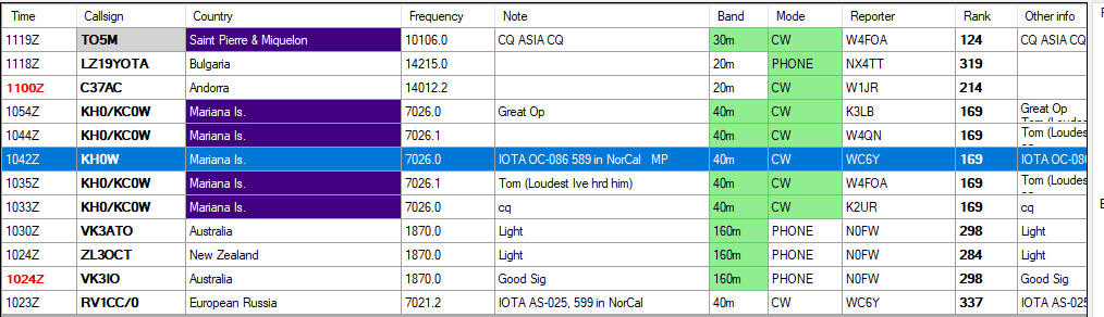

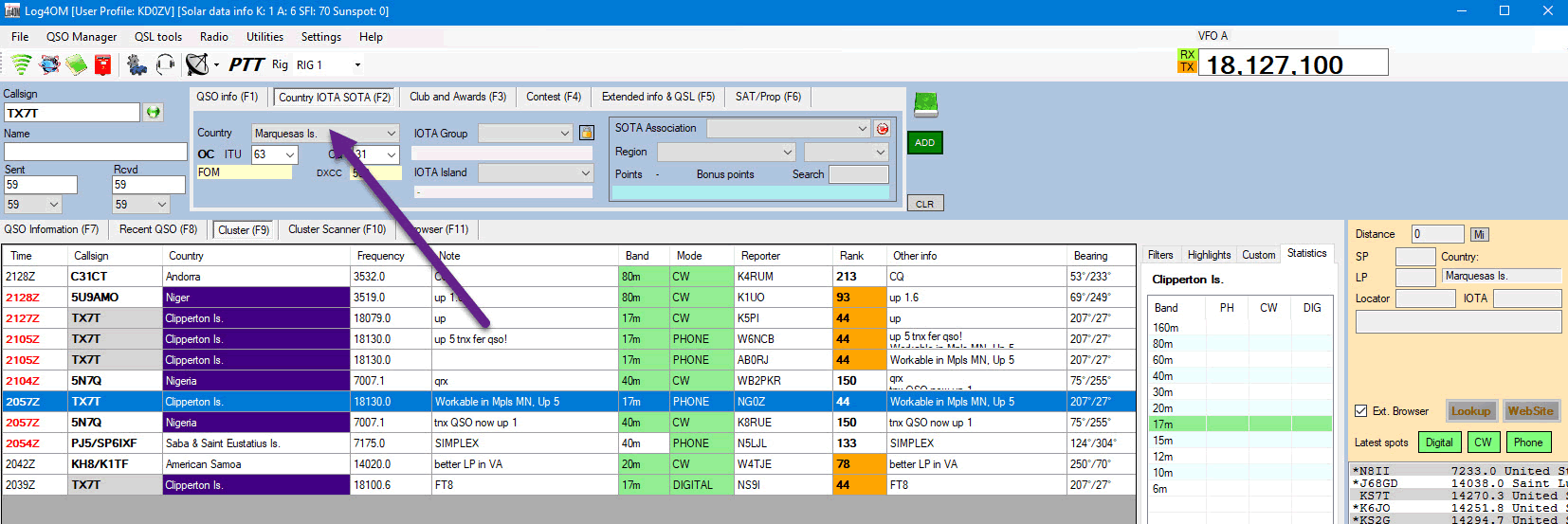

Having the Clipperton Island deal again. This time as TX7t
Does not show up correctly in the cluster but does show up in the details above. I have worked them 5 or 6 times on various bands/modes and was correct until today
Another local ham is having same issue. All the databases are updated and club-log exception is on. Using QRZ for lookup
Any idea?
Rich
Any idea?
Rich

As we have said a couple of times the cluster only does a quick check against the country database for the call whereas when the call is entered into the call sign entry field a full lookup[ of all sources both online and off line so that is going to be the most accurate all of the time.
In version 2 the system is very different so these anomalies will not occur so often

OK,
Well the lookup is OK as it puts it in the country (F2) area. Just the cluster.
So hopefully version 2 will fix it

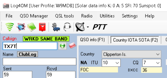

TX7T does not show up correctly here. I've updated all the databases and restarted Log4OM.
I also tried logging it (from WSJT-X) and it does get inserted correctly as JTAlert does the DXCC lookup...but still the F2 tab in Log4OM shows Clipperton.
I tested with a friend and his shows correctly on the F2 tab. We thought maybe logging it would make a difference but it doesn't (even after a restart).
The clublog.xml does show TX7T correctly.
So how do I figure out why this is wrong? The debug info only shows the log lookup and nothing else.

Mike, I am guessing since they are so close to Version 2 which apparently is all different they are not going to be putting any effort into fixing this. I personally think its a Log4om issue but I am not concerned since V2 is just around the corner.
Its a big hassle for me because TX7T switched in the middle and then I could not longer look at the Statistics because It no longer showed bands/modes worked. It was empty because it was looking at Clipperton Island and not Marquesas Islands.

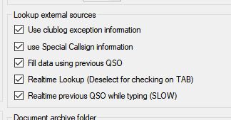

1. Do you have the Settings 1 options as shown below?w9mdb wrote: 18 Nov 2019, 17:04 TX7T does not show up correctly here. I've updated all the databases and restarted Log4OM.
2. Are you using version 1 release 1.40?
