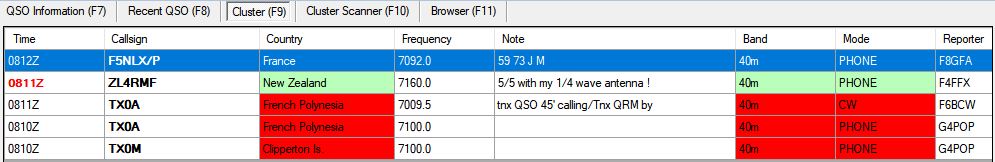

How is TX0A and TX0M displaying for you? Both show Clipperton Island for me.
Rich

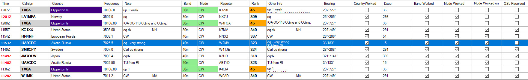

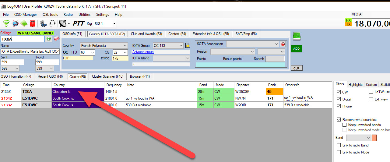

This may have been fixed in the SCL after I worked them on the 6th and 7th. I had manually updated it prior.
I just worked TX0A and it logged it correctly, however the cluster is reporting it wrong.
Where does the cluster country info come from?

This is the result that I get
Dont forget that the cluster only checks the country file for the country name which is closely tied to the ARRL DXCC prefix list, whereas when the call is added to the call sign field the complete lookup of all local and online resources is completed.
Applying a lookup of all resources for the cluster country name would be very time consuming and slow things down badly.

This is my latest. Cluster not showing VI9NI country in the cluster. It shows in details above.

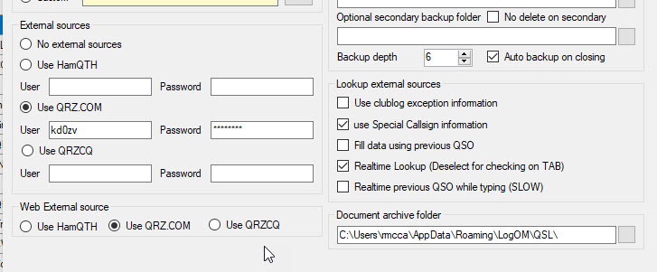

Attached are my settings.
I can see some info under country but not showing in Cluster I guess.

Re: Call sign challenge
Try "Use Clublog exeption information"
