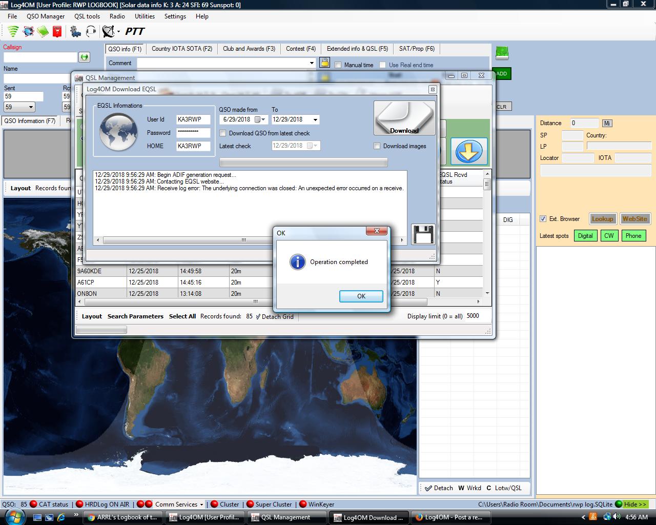

ok will send that over asap, after downloading the new version eqsl will not upload or download now... click the upload button does nothing and gets an error on download

reloaded old version that I was using before, did not change anything and eqsl is working again... still no good with LOTW, also I noticed that in the new version when I launched cluster, the call sign was ok but no country...
