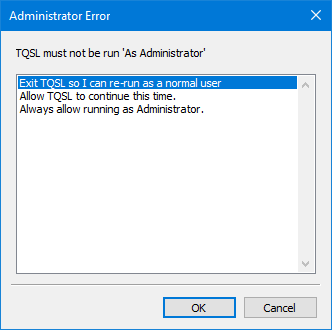

Re: upload tolotw
My 2.5.1 worked the first day and now is giving me the administrator error message.

Re: upload tolotw
Well I am still battling this.
Posts: 11605
Re: upload tolotw
There are instructions about that on the LOTW web site, basically either change TQSL properties or click allow all the time
