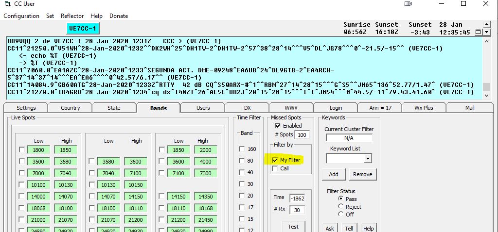

It seems you have two Active Server connections both using VE7CC Cluster, one local via CC user (Secondary) and one directly connecting to VE7CC.net on port 7373 (Primary). If you disconnect from both cluster and open the Realtime log under Help and then reconnect, you'll see the connection to both of your configured Active ClusterServers.
1.) Are you using the same SSID for both connections ?
2.) How does your CC user setup look like under Bands -- My Filter ? Is it ticked ?
Because "My Filter" enabled (ticked) = sh/mydx

I really don't use CC user on a regular basis. I just opened it and yes "My filter" is ticked.
that is exactly why you see historic old spots. "My filter" equals to the command "sh/mydx" which are not processed at all by Log4OM filtering.

But I think you need to have Missed Spots Enabled check box checked for that to take affect
If you have "Missed Spots" and "My Filter" enabled in CC user = sh/mydx/100 (referring to my screenshot).
