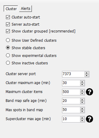

I assume the cluster time maximum age applies to everything including local spots?
If so wondering why I am seeing these spots. Just one at moment but I have seen more in past.
This spot from CW skimmer was 3 hours ago.
Here are my settings.
So why am I seeing this spot?

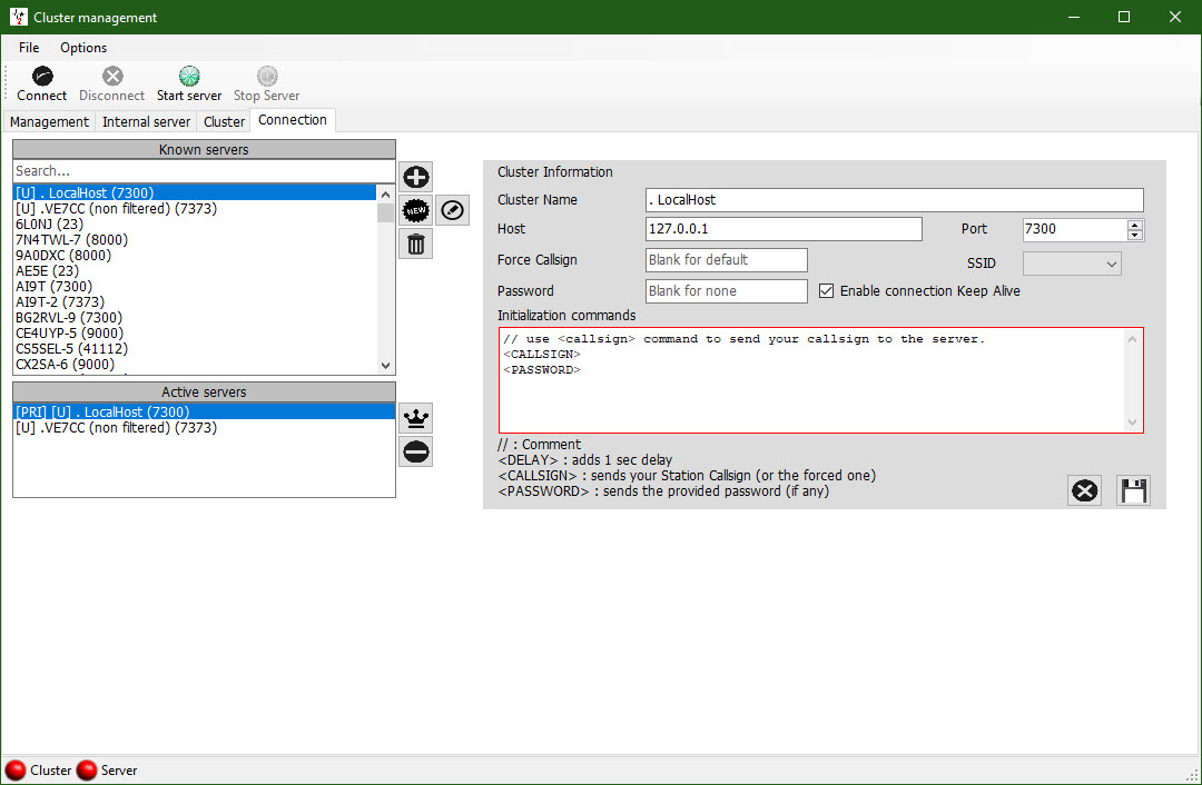

Hi Doug,
I do not have that on either the VE7CC cluster or the localhost.
Rich

It looks like your Primary connection - (Pri) - is connected to CC User. Check CC User for similar initialization commands.
Then check your other connection - VE7CC for initialization command. Your screen shot only shows the localhost connection...,

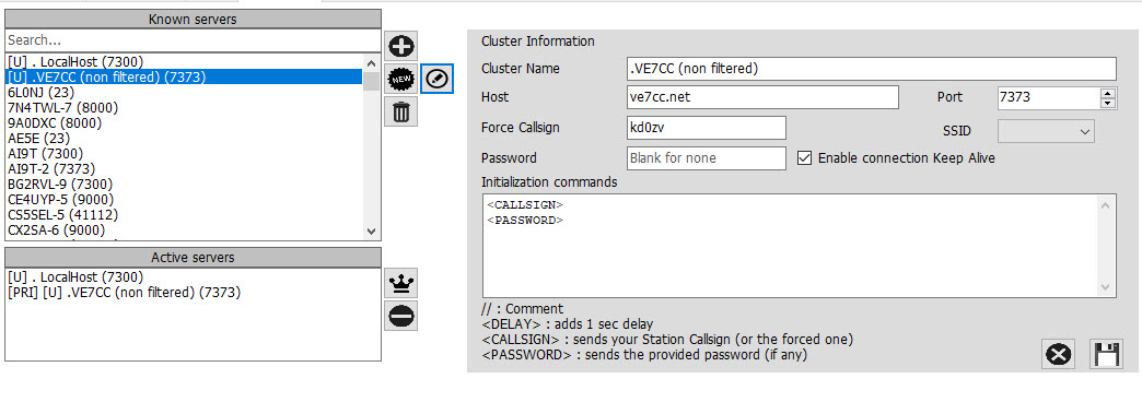

Doug,
Same settings on VE7CC
Rich

Rich,
Looking at your screen clips you are effectively logging into VE7CC three different times. At least two times for sure.
You don't have separate SSIDs for your logins. As I recall SSIDs up to 14 or 15 will receive all the same filter selections. SSIDs above that are discreet for each one.
Logging into the same cluster with the same or no SSID can sometimes cause issues. No SSID is actually "0".
Lee Sawkins has a short paragraph or two at his website where you download CC User from.
I'm not saying this is an answer, but might be something to look into.
