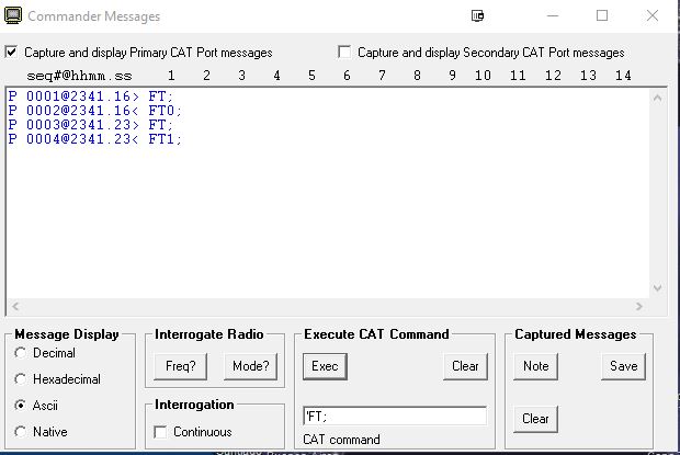

wo9b
Posts: 36
Joined: 17 Jan 2020, 20:05
Re: CAT Frozen on SPLIT for FT-891
Post by wo9b »
What an odd response when monitoring the commands channel.
The only detect I saw was an RI response. It varied from RIC1 to RIC0 both in concert with the change between Split "on" and Split "off" as initiated by key presses on the User Programmable Front Panel Keys.

So now when you leave the CAT Messages open and start Log4OM what output do you see in the CAT Messages ?
Can't find RIC1/0 in the CAT Manual.... its says 'ST; is the command to read Split Status.
ST0=Split OFF
ST1=Split ON
Flex 6600 - Spiderbeam

I agree that the split command is ST; on the 891 with a status of ST0 or ST1.
I don't see any mention of ST on the Commander's output for the COM port. Puzzling.
I have a call into Yaesu to clarify a couple of items. The struggle continues.
