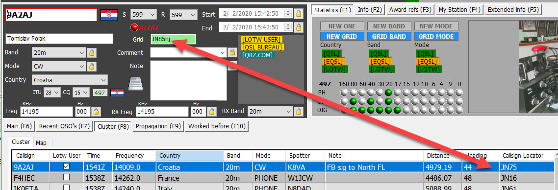

HB9VQQ wrote: 02 Feb 2020, 15:41 I went through my last 10 QSO's and and compared it with my primary info provider. All were correct.
So what is different about my setup? 90% of mine are incorrect.

Sorry my fault, I missed the part where you said the problem is with the cluster info...
I can duplicate that, tested with cluster simulation and I do get wrong Grid info displayed in cluster window.

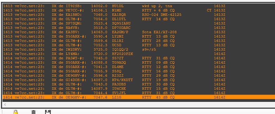

Juergen there is no grid info in cluster spots. You can test the behaviour with cluster spot simulation.

Well Log4OM apparently us supplementing incorrect info some how.

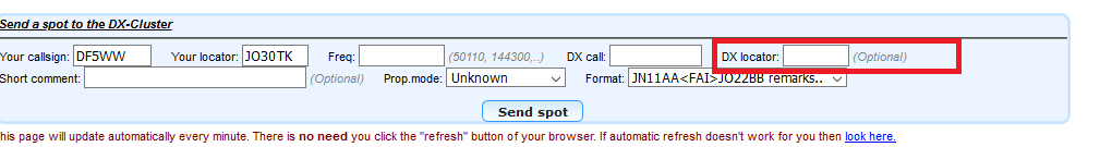

Only as example. I´m a user of a website which providing also spots above 30 MHz. If i send a spot i go
into the side and i have the possibility to send also a locator which is not provided by any external
serviecs
serviecs
Juergen with Spot Simulator there is no way to ingest a grid locator. Also if you look at the spots from VE7CC there is no grid info.
You can test the wrong grid reporting easily with Spot Simulator Juergen.
