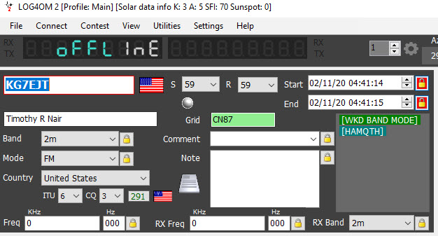

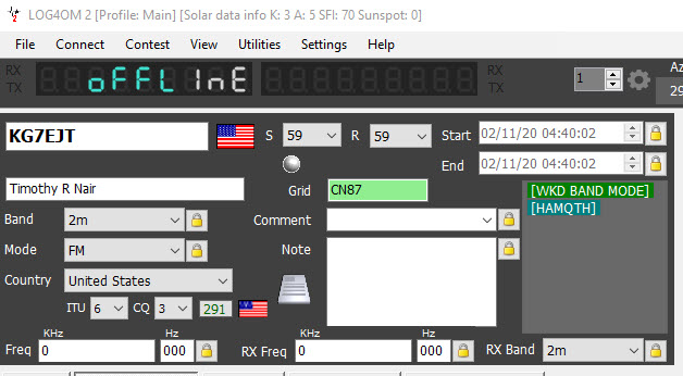

I start up Log4OM and if I do not lock the time/date fields the CQ zone is set correctly.
If I lock the time/date fields and do not edit them at all, the CQ zone is set correctly.

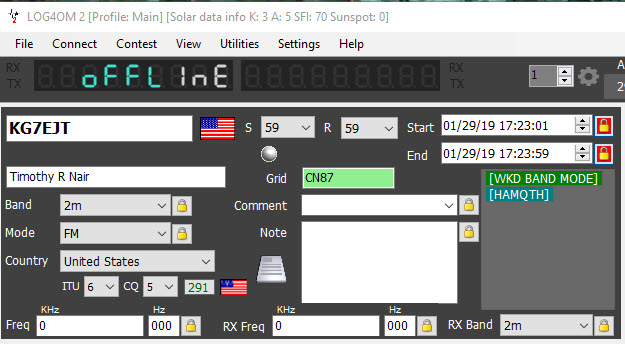

If I edit the times/dates to be some time in the past, the lookup of the west coast call sign is set to 5.
I am attaching the screen shots of the sequence below. The work around for me is that after I save the QSO I then manually edit the QSO and update the CQ field.

- WorksIfDateTimeNotLocked.jpg (67.69 KiB) Viewed 6292 times
- WorksIfDateTimeLockedButNotEdited.jpg (74.84 KiB) Viewed 6292 times
- DoesNotWorkIfEditDate-TimeField.jpg (72.85 KiB) Viewed 6292 times

Hi, that's not an issue of Log4OM.
Log4OM has 2 different approaches to the external sources as data sources.
This is basically because some sources works in realtime, so those works only for "current" QSO, while other sources are able to recover data in the past.

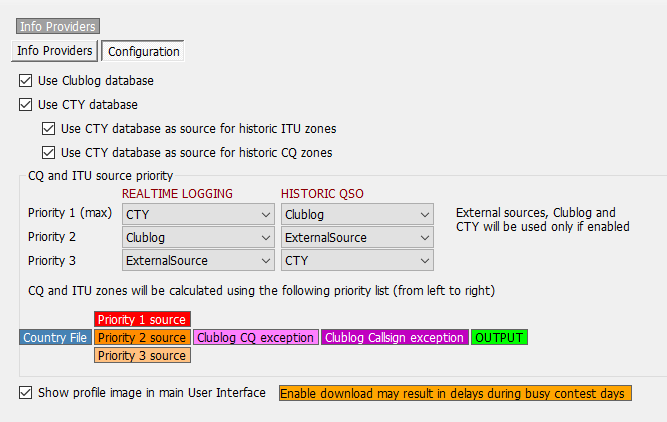

About the callsign you reported, the default REALTIME LOGGING priority for CQ and ITU is:
CTY file
Clublog
ExternalSource (qrz/hamqth/etc)
That means if the CTY has a valid CQ/ITU zone for the callsign, this will win. But CTY file is made to be used for contesting and, generically, for a realtime usage.
That means if your callsign "moved" in the past, the CTY file will provide only data for CURRENT DAY.
This is why, in Log4OM, we have 2 different approaches for "realtime" and "historic" QSO (where historic is all QSO with QSO date different than TODAY)
In the info provider section you can see we give priority to Clublog internal files for HISTORIC qso, then External Sources (QRZ/HAMQTH) and at the very end if nothing is found before, to CTY file. This is mainly because you may have a QSO 10 years old to register and CTY file is not guaranteed for historical QSO's...
The priority order for sources is up to you. If you raise priority of the CTY source in the HISTORIC qso section, it will be used also for QSO registered in the past over clublog default data.
That is a good solution if you're registering recent QSO's, where CTY file is probably exact (like in your situation). This can create some troubles if you're registering a 10 years old QSO from a DXspedition (if the DXSpedition is not registered into clublog callsign/cq exceptions), but this can be easily changed when you have that needs.
Please note we have a fixed priority on CQ and Callsign exception data from clublog (but those data are rarely available for normal contacts)
Please note "Use CTY database as source for historic ITU and CQ zones" flags must be checked to allow Log4Om work with CTY for Historic QSO on the order you selected.
