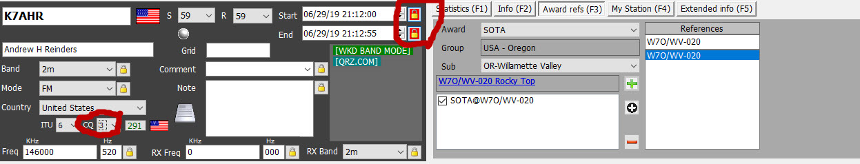

I am working on entering previous SOTA activations into Log4OM.
Preconditions: v2.2, my ref set to SOTA Summit I was on at the time (June 2019), I am in CQ zone 3, my QSO is in CQ zone 3.
In the QSO edit screen I lock the QSO start and end times to be the date/time of the QSO. I then enter the call sign of the QSO. It is shown as 5 not 3.
I reset the CQ zone to 3.
When I save the QSO it is reset back to 5.

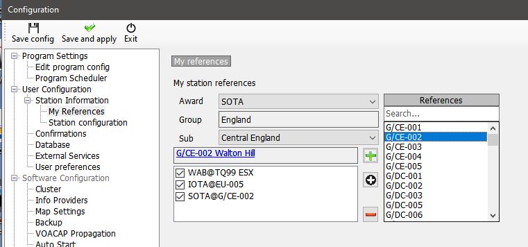

Your SOTA, Locator and zone information is not set in the working screen its set in the Program Configuration/station information and My References tab
My Ref.JPG (57.73 KiB) Viewed 5951 times

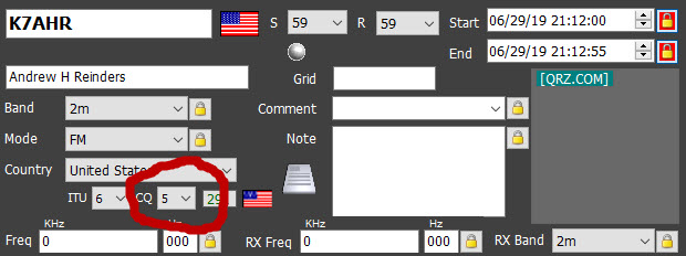

My QSO was on the west coast, a nearby FM contact. His information is coming up as CQ zone 5 when I enter in his call sign. I believe it should be CQ zone 3. I reported a very similar bug in previous release and it was fixed if you leave the date/time values unlocked. But if you lock them the bug still exists as in the previous release, it incorrectly sets it to zone 5.

no this issue is not related to the other post. In the graphic above you can see it is just a K7xxx call sign.
Easy to reproduce. Just lock the date/time fields and enter a west coast call sign which is in CQ 3 and it will come up CQ 5.

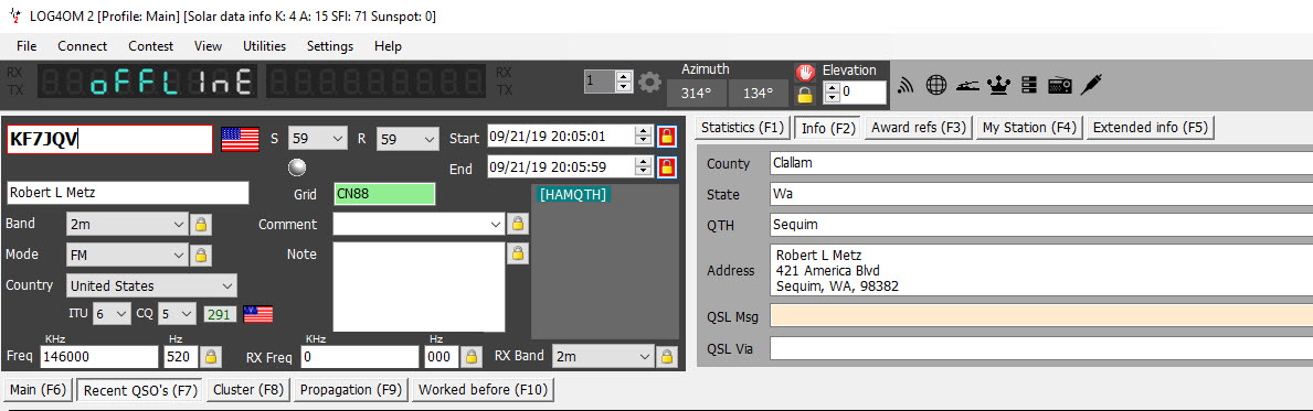

Attaching a screen shot. This is via HamQTH and it is not a contact I had any previous QSO with.

I just checked the call KF7JVQ that you entered and HamQTH has used the default country 4 digit locator so the example is flawed
Please try W7DRM as a test
