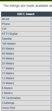

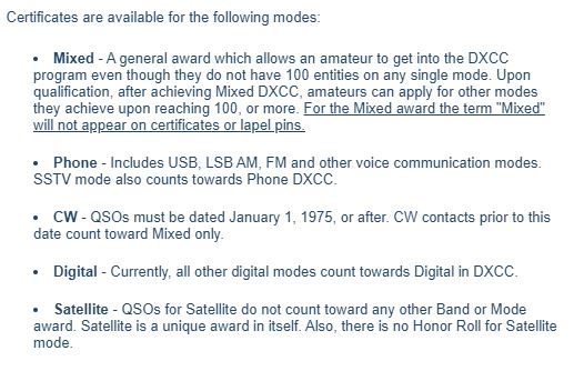

Re: dxcc - wrong status
Morning Daniele
let me attach
1) the ARRL dxcc list
2) the DXCC mode list
they are the official world wide accepted references
let me know if I ccab give you additional help
Don
let me attach
Don
- dxcc_mode2.JPG (46.66 KiB) Viewed 5909 times
- dxcc_mode.JPG (28.42 KiB) Viewed 5909 times
But only for ARRL and DXCC awards and operations there are hundreds of others worldwide with other parameters.
The only specification that is close to being international is ADIF which is what we mainly use
