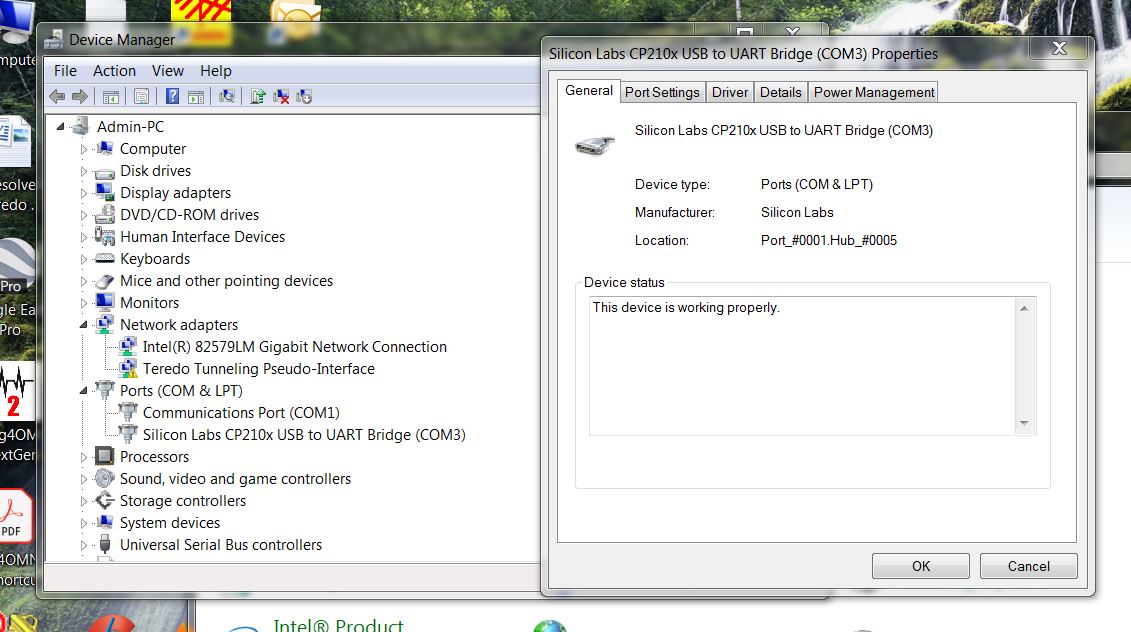

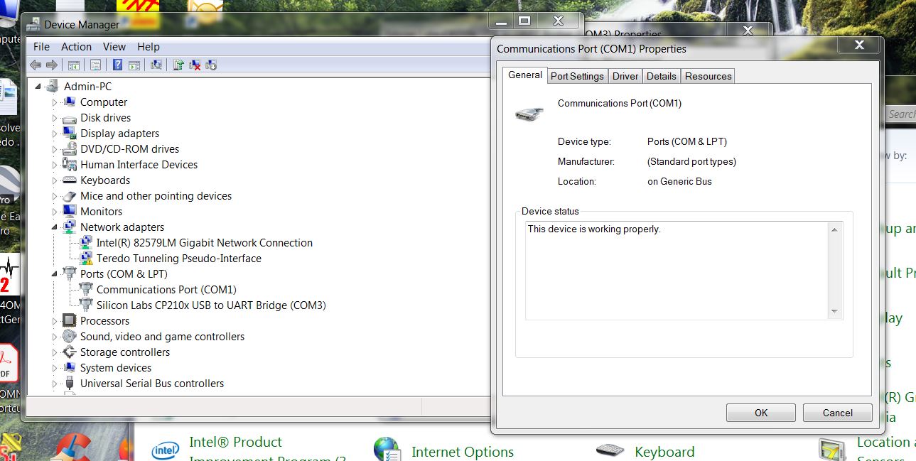

Have a look at the LPT & comm ports just below the and make sure your radio is on when you do so, then post a screen shot of that

Hello Terry,
I thank you for your kind support and advice. I attach the capture files of ports requested whilst my IC-7300 was turned on. 3.753 LSB for club web night hi.
Capture com 3.JPG (124.71 KiB) Viewed 2395 times
Capture communication port 1.JPG (138.64 KiB) Viewed 2395 times
Best 73 take care stay safe Glyn GW0ANA

So Com 3 is the correct port for the Icom all you need to ensure is that the baud rate selected on the radio matches that selected in Omnirig
