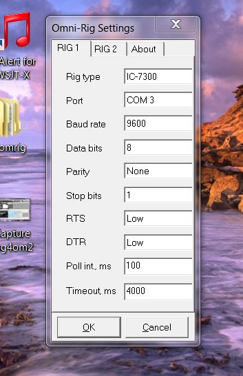

The omnirig program is in the computer and if I click to run it it opens in the small 2 radio setting but no way will it communicate with my Icom 7300. I have followed G4POP YouTube video to the letter but it still will not connect to the program. It did once a few days ago but not now. With log4om2 running, if I go into the cat control settings has a green arrow tick against it but it will not open the Omnirig dialog control panel.

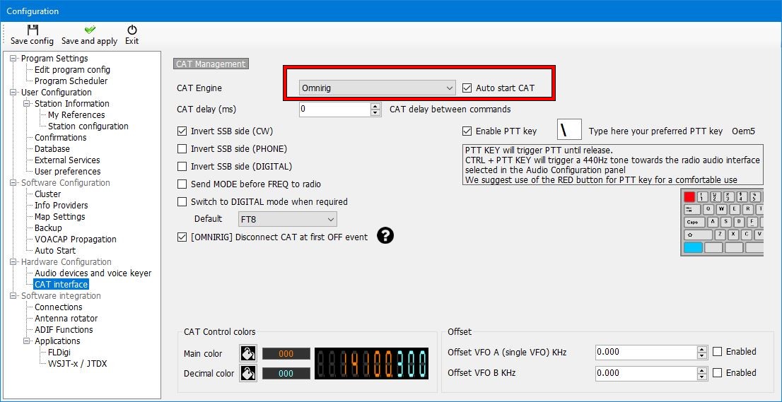

First things first ... Do you have your CAT service set to "auto start" when starting Log4OM V2 ?
See image from my installation below. Go to: Settings / Program Configuration / CAT Settings
Let's get that running first as you have listed several items all in one paragraph and we need to get back to basics.
- CAT-Start.JPG (129.03 KiB) Viewed 6678 times

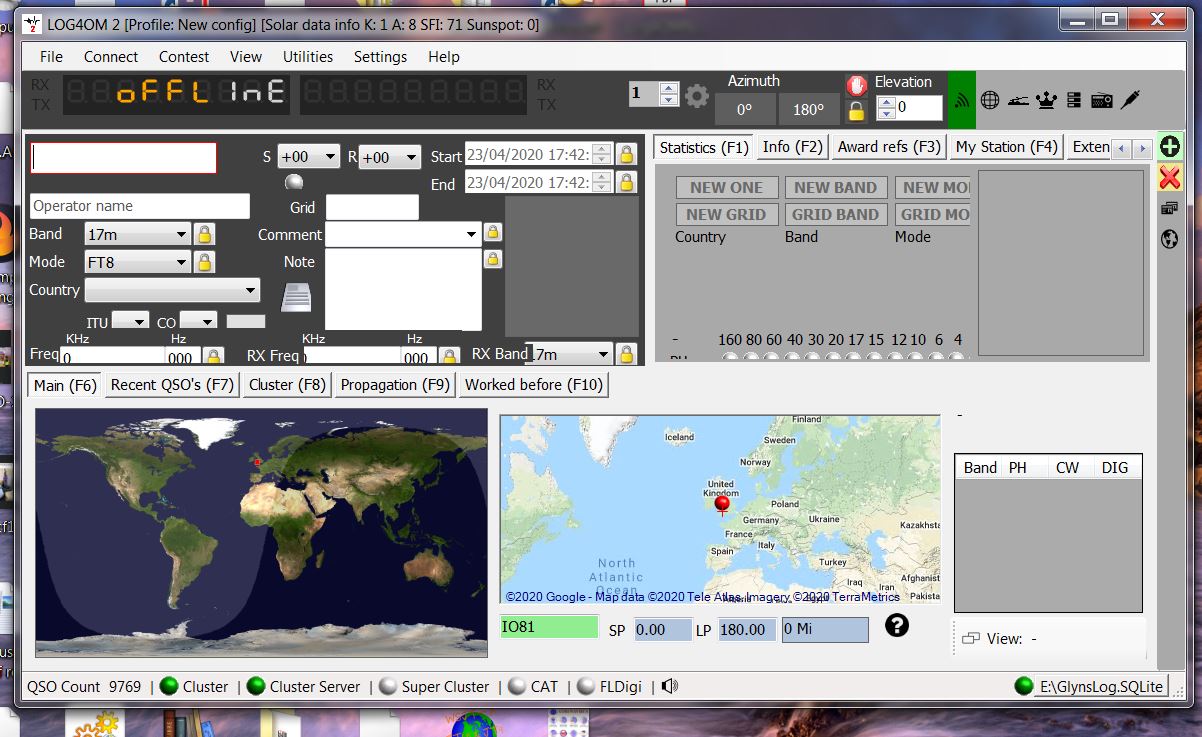

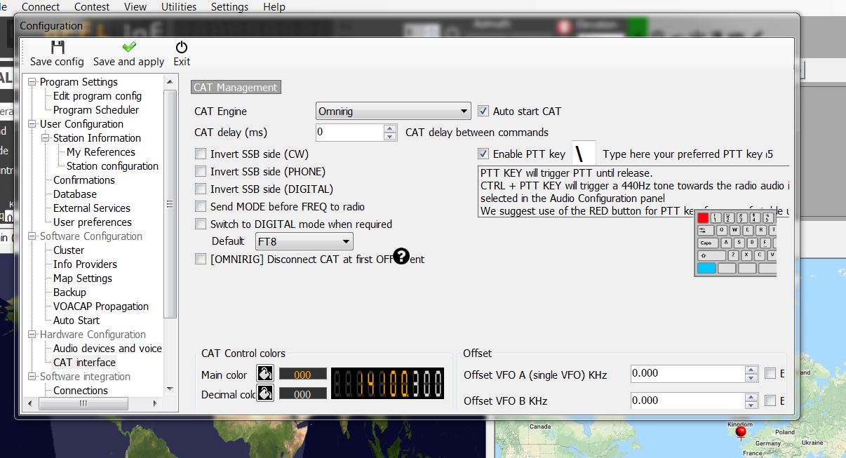

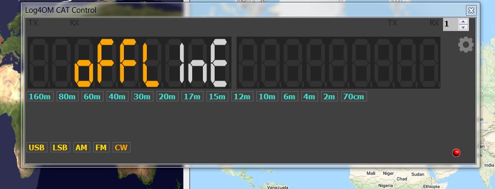

I truly thank you for agreeing to help me. I have done a page capture of my Cat Config and as you will see it is set to Auto. But unfortunately it does not respond. Nor will it open even though there is a green tick against the start Cat . It will not "Show Cat Interface" in the Cat drop down box.But It will show Cat Screen
It is so frustrating it makes one feel so stupid when what ever I try fails.
I have attached two screen captures that may help.

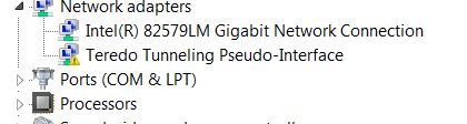

I have spent a lot of time looking into my computer,
In doing so I have found this error >> I am not computer savvy enough to know what it does but I have found this help file that should fix it. Resolve Teredo Tunneling Pseudo-Interface Error From Command Prompt
1. Open command prompt with administrator credentials (Find CMD and right-click - Run as Administrator).
2. Type netsh and hit Enter.
3. Type in int teredo and press Enter
4. Type set state disabled and hit Enter
5. Open Device Manger and Uninstall Teredo Tunneling Pseudo-Interface
6. Go back to the command prompt and type in netsh and hit Enter
7. Type int ipv6 and press enter
8. Enter in set teredo client and hit Enter
9. Go back to the Device Manager and Scan for New Hardware.
10. Select Show Hidden Devices from the view menu. The Teredo Tunneling Pseudo-Interface should now be present with no errors.
11. If the above steps did not resolve the issue, there are also steps that can be taken to edit the registry to resolve the error message.
I tried looking for a new driver but computer stated that driver was the latest?. Again many thanks 73 Glyn
