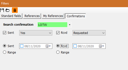

OK Terry and Paul that works fine but it's not my question
My question is about the "filters" option on below the logbook ...
have you tested ?
Thanks again and thanks to Terry for his patience ...
Dan - F6FLU

@Terry
FYI if I don't use the date system that works fine :
Recherche LOTWS ET LOTW non reçus sans date 2020-11-08 160123.png (11.72 KiB) Viewed 2091 times
But if with the same search I select a range of Date that doesn't works
Dan - F6FLU
https://F6FLU.org

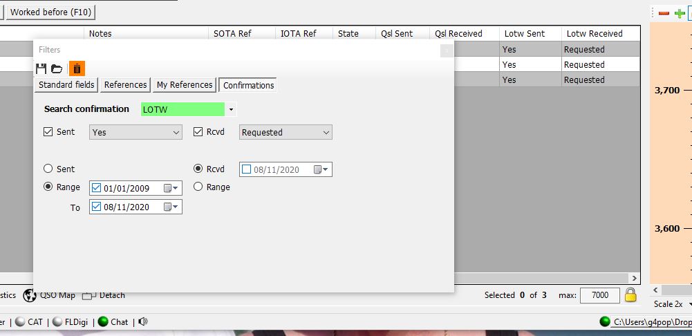

yes Terry I agree BUT
if you add also the same range to LOTWR as Requested ???
Dan - F6FLU
https://F6FLU.org
Re: Search LOTW sent but not received
F6FLU wrote: 08 Nov 2020, 16:02 yes Terry I agree BUT
I think I need to expand this in the user guide because I must admit it's a bit confusing!
When doing a search JUST on sent status the left hand date and date range applies
When doing a search JUST on received status the right hand date and date range applies
When searching on both sent and received status Only the left date and date range applies.

Ah OK Terry
I didn't understand that ...
Many many thanks ...
