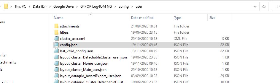

Re: Portable version update
Perhaps this will help its the path to my PORTABLE version that I store on the cloud
D:\Google Drive\G4POP Log4OM NG\config\user
Here is the file shown in the above folder
