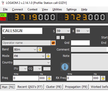

This problem has suddenly re-appeared (maybe due to a Windows update I received). I have attached an image showing the missing data. The rig+Omnirig+Log4OM are obviously talking to each other as the frequencies of the VFOs at the top of this image change with the frequency on the rig, and also can change the rig frequency. The 'Band' value does not change with the rig. I was not in FM mode either!
Where are the frequency boxes at the bottom of this image derived from? It seems strange to me that it is not the same source as those at the top of the window.

1. What a poor choice of name for software! Thetis was a submarine that sank in1939 and claimed 96 lives, the first Thetis also sunk killing all the crew!
2. I guess your using some sort of VSP have you checked it's not that?
3. Have you tried a CLEAN install of Log4om from a fresh download
5. What version of .net framework is installed on your pc?
6. What is the Omnirig version number?

OK first thing to do is update the Widows .net framework because its well out of date, current version is 4.8.xxxxx
Having restarted the PC after updating let me know the result

The only other things I can suspect are either the Thetis connection or the VSP (ComOcom) connection, have you reinstalled them?g3ziy wrote: 24 Jun 2021, 06:32 I tried to install .NET Framework4.8 but it refused saying v4.8 or later was already installed. So I must have found an old version when I earlier reported v4.0.xxx
Try a lower Baud rate like 19200
