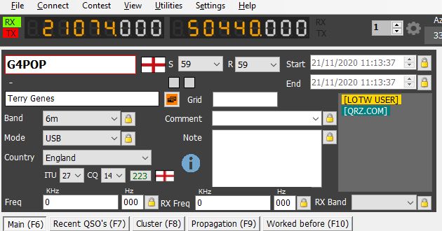

Log4OMv2 is not displaying data below the operator's name box. It was working ok until last Sunday (v1.9). When v1.10 was available I upgraded in the hope it would 'come good', but it did not.
As you can see from the attached image, it does not pick up the band, mode or frequency, and yet clearly the rig and Log4OMv2 are communicating as the VFO-A and VFO-B are displaying correctly, and they change in sync with the rig.

As Log4OMv2 is clearly communicating both ways with the rig (it reads and sets the VFO A and B frequencies correctly), I find it strange that the frequencies/band/mode boxes are not being displayed in the program.

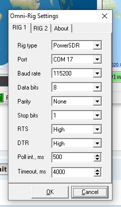

I did all you suggested to no avail. However, as the correct frequencies are showing in the VFO A & B windows, I don't think comms is the problem. This is my CAT config:
Posts: 11593
Re: No data showing below operator name
Nothing wrong with that, it's unusual because with CAT control its normally all or nothing.
