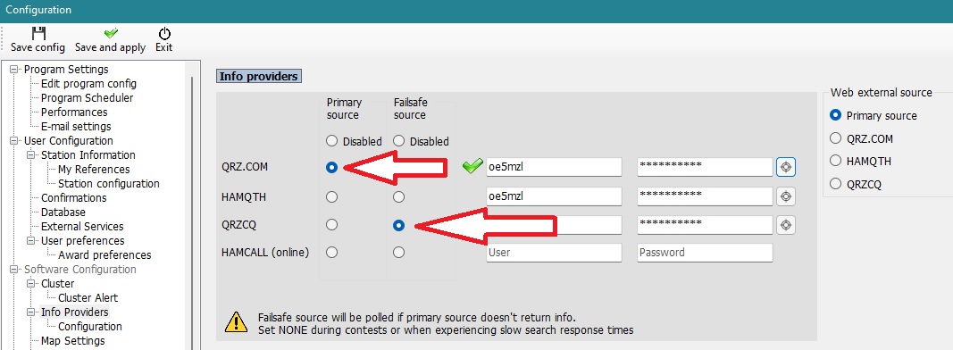

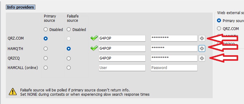

And what happens when you click the test buttons indicated below by the red arrows?

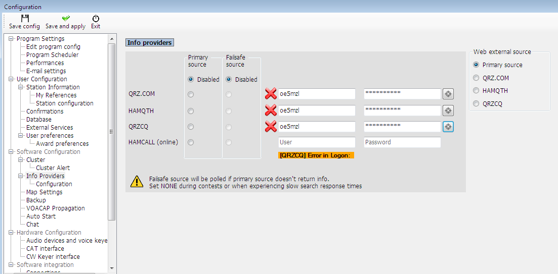

oe5mzl
Posts: 9
Joined: 02 Oct 2021, 10:35
Re: Provider Look up doesn't work
Post by oe5mzl »
Posts: 11593

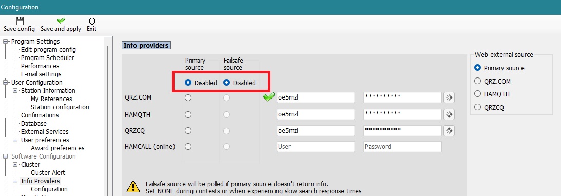

OK I actually missed the issue in the screenshot that you posted but having installed your config file that you emailed me onto my PC to replicate EXACTLY your settings I noticed that you have both primary and secondary lookups DISSABLED!
I selected the sources and everything works fine including the test lookup.
This is your set up using your config - The disabled checks are stopping it using the lookups!
Lookup 1.jpg (100.95 KiB) Viewed 2753 times
This is after I changed the settings, note the test is working.

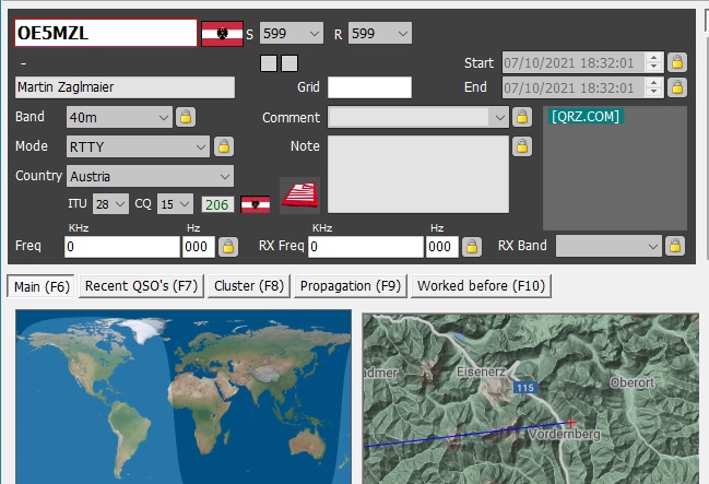

And just to prove it all works here is a live lookup of your call.
Lookup 3.jpg (103.37 KiB) Viewed 2753 times
