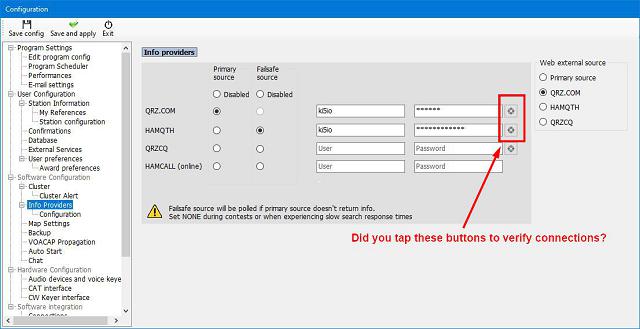

When in the Configuration / Info Provider tab be sure to check/tap the button at the right side of each info location (QRZ, HamQTH, etc.). Tapping that button will confirm (or not) of your login and password is working.
See image below that I used with another OM late last night with similar question here on Forum.
