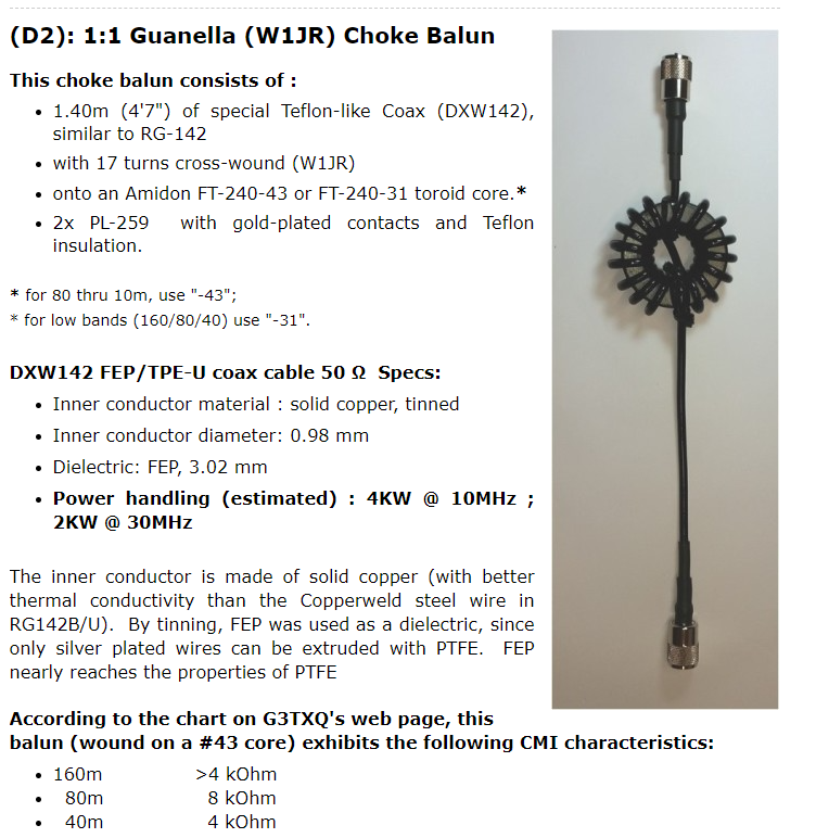

NO
I make my own and a good reference site is here https://www.dj0ip.de/rf-cmc-chokes/diff ... of-chokes/
NOTE: The toroid core type is very important so make sure that you buy the correct one 240:43 for 80 through 30m and 240:31 for 30m through 10m
See http://www.karinya.net/g3txq/chokes/ for details about Toroid and frequencies
I use RG58 coax which is fine for all HF frequencies if you keep the pigtails short
This is the design that I use
