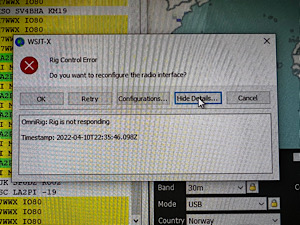

More Omnirig woes…
I constantly get the attached error when working FT8, especially in the higher frequencies. 40m is the mosr stable, 20m and above less so.
It breaks the transmission routine. Clicking Retry sometimes allows me to carry on, other times I have to switch to lower frequencies.
Any ideas why?
Thanks in advance,
Simon (M7WWX)

If i see right your TX was transmitting while you make the sceenshot. The vertikal lines telling
me that your HF is coming into the shack. If you have connected your BB-7 with coax cable to
a tuner in the shack it´s not a wonder that you have effects like this. A common choke would
help but the power you put out at the antenne is around 80% less then the output on the TX.
In this case you need a tuner at the feedpoint of the BB-7 and you need a common choke between
the tuner and the TX. The common choke next to the tuners side.

No, that’s just a phone photo of the computer screen! There is no interference on the monitor at all.
Thanks for the advice.
