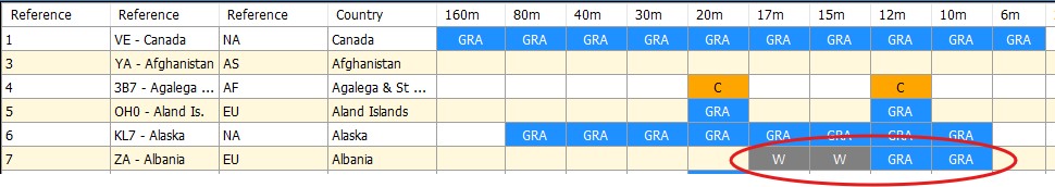

Still not working in 2.32.1.5
Albania is worked on 15m/17m with ZA5G and validated on 10m/12m with ZA/IW2JOP. So I generate a 15m spot on ZA/IW2JOP and no alert.

- Screenshot 2024-06-18 082758.jpg (20.57 KiB) Viewed 6645 times

ZA5G is worked on 17/15
ZA/IW2JOP is worked on 10/12

Testing 2.32.1.6 -- still broken -- I have include debug below for both the bad one and good one....
21091 spot does not alert
7074 spot does alert
1222 Simulation: DX de W9MDB: 21091.0 ZA/IW2JOP FT8 1222Z
1223 Simulation: DX de W9MDB: 7074.0 ZA/IW2JOP FT8 1223Z
ZA/IW2JOP is worked on 10/12 ===============================================================

As of 2.33.05 this is still broken.
Re: Cluster alert band not confirmed is broken
As of 2.33.0.6 still broken -- here is one example of an already worked but not confirmed followed by a new band alert.
I'd hope that this would be some sort of priority to get fixed as people are missing DXCC alerts from the cluster spotting.
