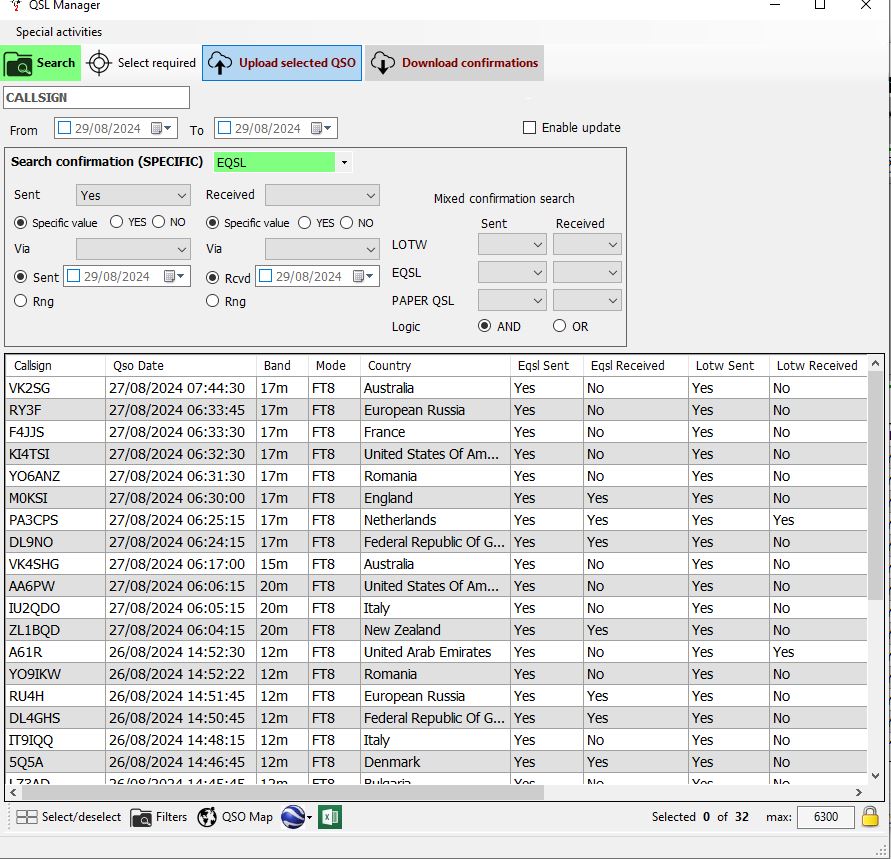

ok Terry when i put in sent ...... Yes it comes back with 32 searches

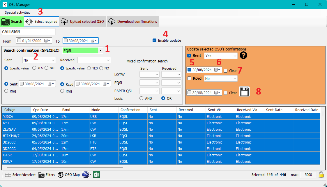

You really need to watch the videos and read the user guide but here is a step by step of how to update the confirmation status - follow the RED numbers in order
You could also do 'Requested' if that is what your config is set to.
Same proceedure for LOTW and other external services

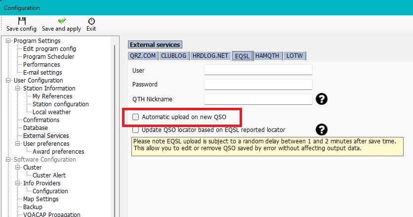

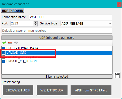

Ok Terry I did all what you said and it now works except on the log book I have eqsl sent and Eqsl received plus lotw sent and lotw received i now have to do the received manually , am I missing something there or should it be automatticslly
Posts: 11591
Re: HELP !!!!!!!
ZB3Z wrote: 02 Sep 2024, 08:05 Ok Terry I did all what you said and it now works except on the log book I have eqsl sent and Eqsl received plus lotw sent and lotw received i now have to do the received manually , am I missing something there or should it be automatticslly
This is all in the user guide but just to conclude this lengthy thread!
Ensure the boxes with the red outline around them are checked
Ignore the port numbers and other data they were just used to create graphics for this post
DONT FORGET TO CLICK THE 'SAVE' BUTTON IN ALL CASES

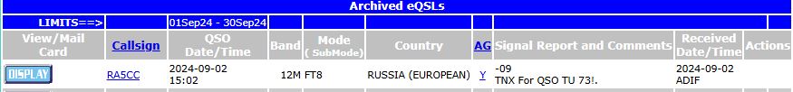

checked what you suggested Terry it is sending them( but not receiving well not on my end) I have closed all the programs this is the only thing i have open is this so as i had the QSO at they started at 14:57 ( just to try ) so i have gave it enough time for eQSL & LOTW wouldnt you say
ZB3Z
Posts: 45
Joined: 29 Feb 2024, 16:59
Location: Gibraltar
Re: HELP !!!!!!!
Post by ZB3Z »
oops so sorry forgot this QSO on eQSL
