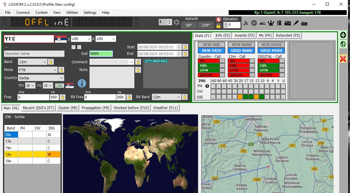

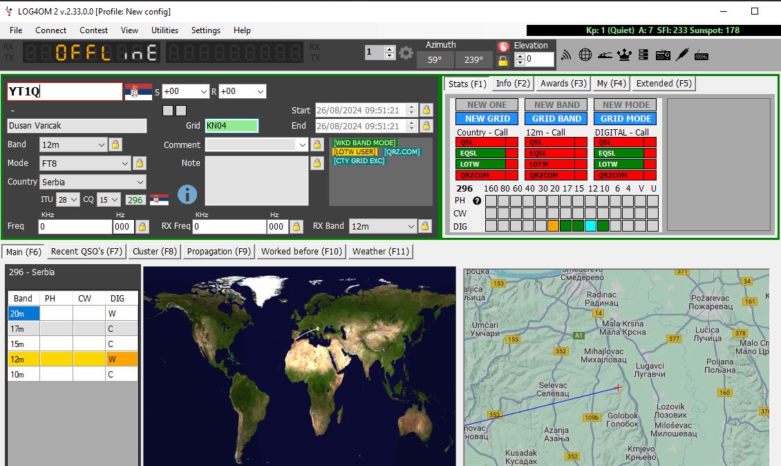

ok peeps i really needyour help on this one , I had a QSO on FT8 with a station from serbia YT1Q on 12m so i looked in my LOTW and it had been confirmed but yet on Log4OM no Confirmation what have i done wrong also guys i have always searched just for the first 3 digits of the call sign but it only shows serbia as worked but yet if i type the complete call shows a light blue box. thanks guys

Re: HELP !!!!!!!
User guide page 35
Light blue = 'CALL SIGN' worked on band/mode
Dark Blue = 'CALL SIGN' has also confirmed on band/mode

Thanks Terry so as soon as i work out how to confirm it on Log4OM from LOTW ( as it has been Confirmed and i do have auto ticked ) it will show dark blue ?
