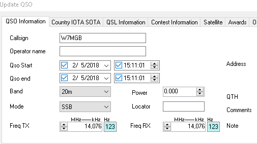

Maybe I am doing something wrong here - it is obvious that this is not a widespread issue. When I try to manually enter QSO information, this screen ONLY accepts a comma, as in 14,076.123. It does not let me enter this as 14.076.123 - if I try to enter that, it ends up as 14 (MHz), skips right over kHz and goes directly to the Hz field.

Just enter 14076 without any decimal point or comma and hit the tab button on your keyboard to enter the Hz, the decimal point is entered for you?
Re: QSO/QSL Logging (LotW, eQSL, etc)
It does enter that, but only on the screen shown here (previous post) but it never enters in to the actual log that way.G4POP wrote: 05 Feb 2018, 16:29 Just enter 14076 without any decimal point or comma and hit the tab button on your keyboard to enter the Hz, the decimal point is entered for you?

Sorry! I thought you were querying the method of frequency entry, which is designed to be without any separators.W7MGB wrote: 06 Feb 2018, 00:53It does enter that, but only on the screen shown here (previous post) but it never enters in to the actual log that way.G4POP wrote: 05 Feb 2018, 16:29 Just enter 14076 without any decimal point or comma and hit the tab button on your keyboard to enter the Hz, the decimal point is entered for you?
I am aware that you have an issue with the actual data record and have already requested that Lele takes a look at that.
