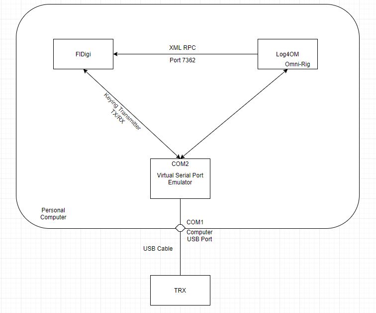

but for everything to work well you need to use vspe software ?
Andrew.....SQ5TDZ

Re: always no tx fldigi & log4om
Post by HB9VQQ »
You need a virtual serial port emulator.
Flex 6600 - Spiderbeam

HB9VQQ
Posts: 237
Joined: 16 Jan 2020, 21:19
Location: Switzerland
Post by HB9VQQ »
If two Programs want to talk to the same physical USB Port you always need some sort of virtual serial port.
