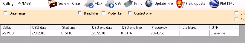

If I look at the raw data in the MySQL DB, it shows as "7074.123" When I enter the data in log4OM, just typing straight through -- 7074 then a "dot" it shoots me to the Hz where I enter 123. Then I look at the QSO Archive, and I see it as shown above in the screen snippet I attached.

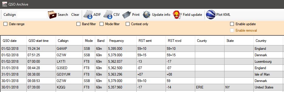

How is it displayed in your QSO Archive? You (and, assumingly, everyone else), they see;
7.074.123

I use the standard SQLite database and my QSO archive manager results are as shown below, same result in all other windows.

Log4OM stores frequencies in KHZ. After decimal point indicates Hz (144555.678)
ADIF protocol requires frequencies are expressed in MHZ. So everything after MHZ is after a decimal point (14.555678), driving up to 6 decimals to save until single Hertz.
CAT software like Omnirig reports frequencies in Hz (144555678)
Due to several problems with local user number formats, decimal separators and other similar issues we decided to "force" the format into database that way.
Despite the local display of the number, you should see in DB frequencies like 144MHz 600KHz (R0 VHF) represented as 144600.000 This will be exported into ADIF as: 144.600000
The format shown on Log4OM is using the user local configuration, so comma or dots for decimal, and vice-versa for thousand separators.
Internally the format is ALWAYS without thousand separators and with DOT as decimal separator.
The field format in the database is a STRING for several reasons (mainly related to portability and precision up to 6 decimal points) and it is internally converted into decimal when needed
