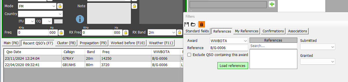

Good evening, how to use QSO filter for WWBOTA and all references e.g. B/G-xxxx?
Thanks for your help

Just close the filter window and it will list just QSO's with B/G- NNNNNN references

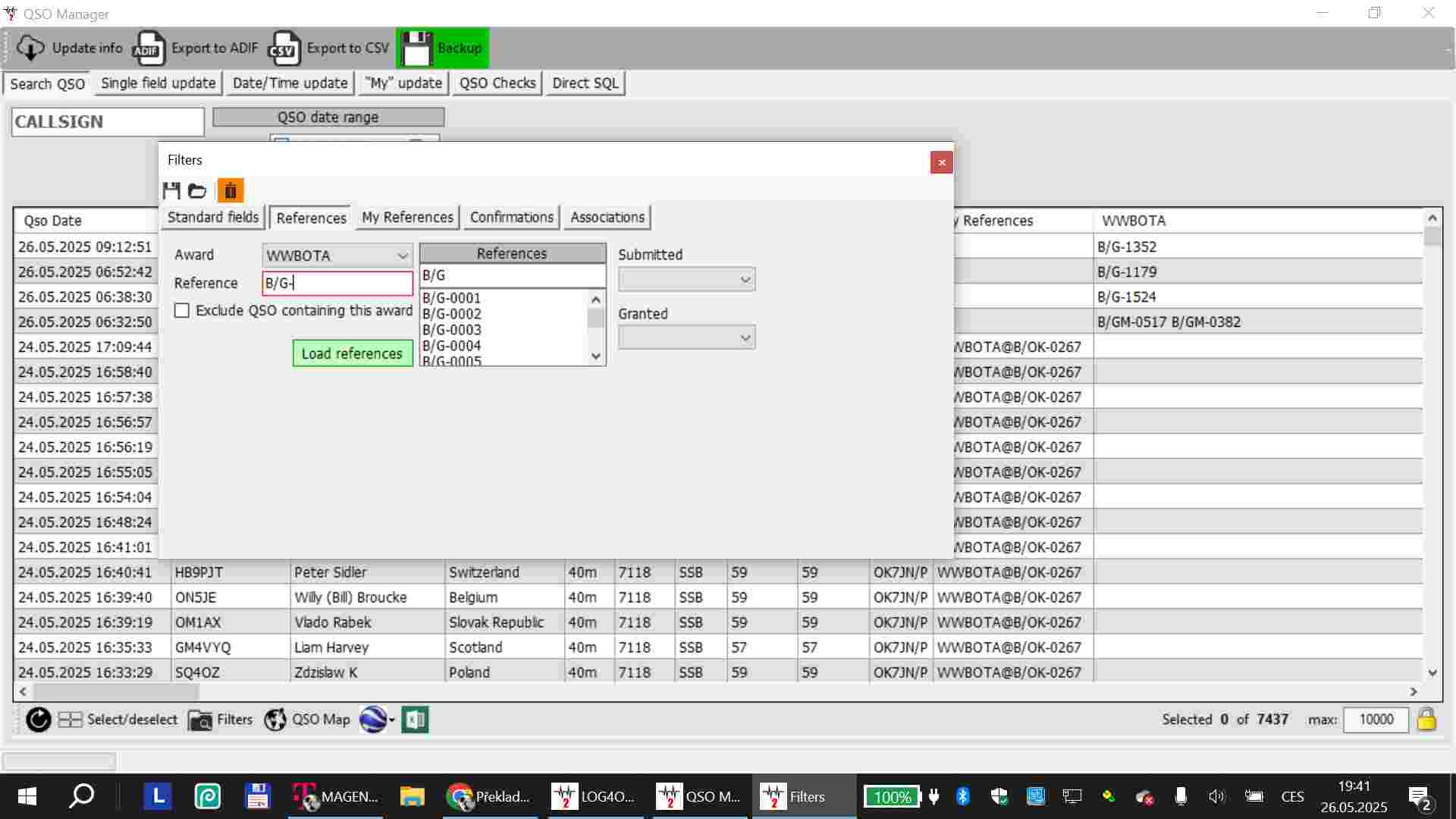

Hi Terry, I tried closing the window but it doesn't filter anything.

Works for meOK7JN wrote: 26 May 2025, 19:36 Hi Terry, I tried closing the window but it doesn't filter anything.
If you dont enter a ref it shows all BOTA worked
Re: QSO Filters
Thanks for the answer Terry. I meant to use the filter only to filter out references, for example all B/G- (B/OK- etc.). As you write, if I don't enter a reference, it will show all processed WWBOTA references (B/G-xxxx, B/OK-xxxx, B/LA-xxxx etc.), or. the exact reference (B/G-1234, B/OK-0123 etc. - this also works)

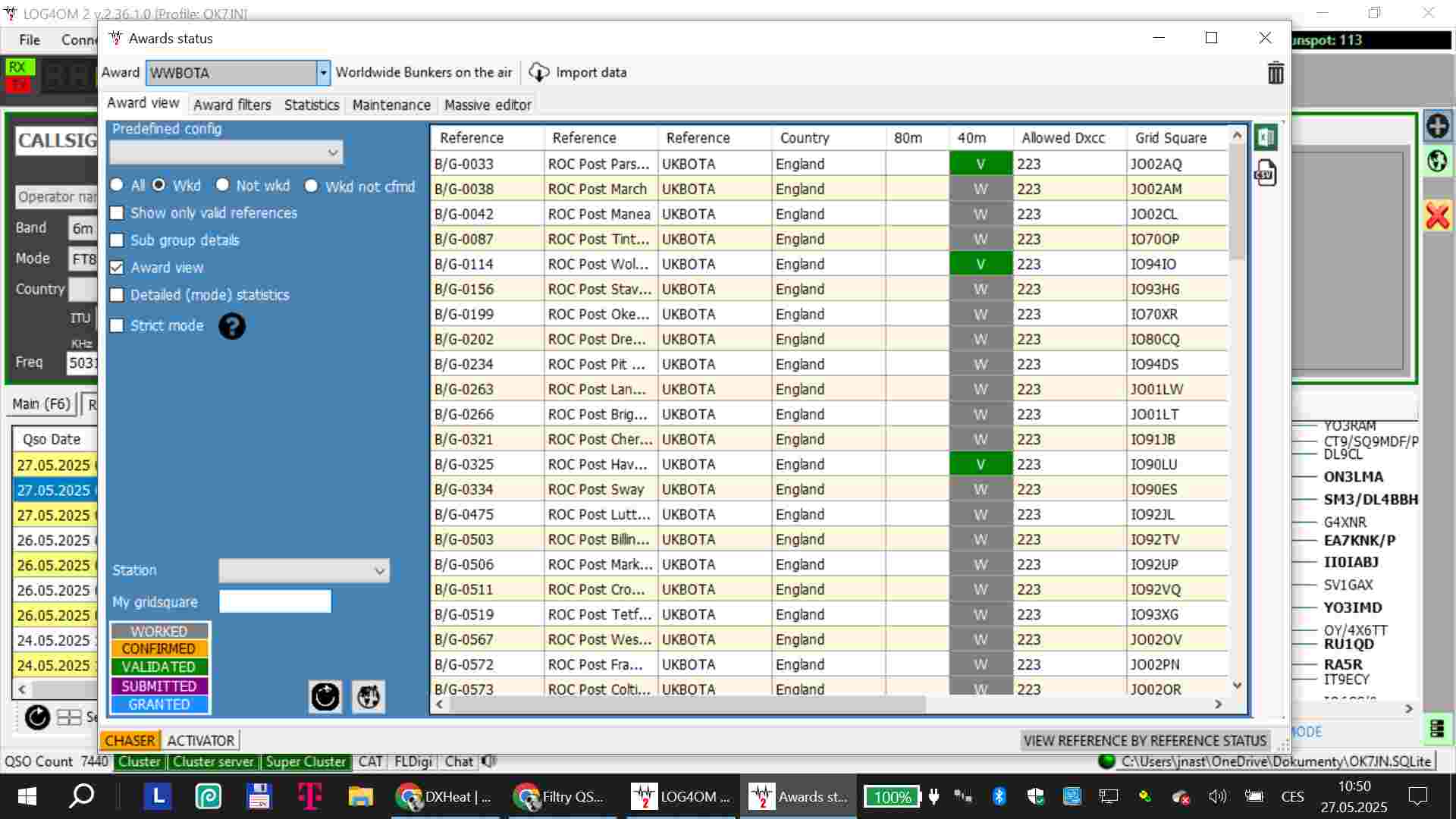

I assume that you have good reason not to use the View/Award status/WWBOTA award and then filter by country or award parameter?OK7JN wrote: 27 May 2025, 04:28 Thanks for the answer Terry. I meant to use the filter only to filter out references, for example all B/G- (B/OK- etc.). As you write, if I don't enter a reference, it will show all processed WWBOTA references (B/G-xxxx, B/OK-xxxx, B/LA-xxxx etc.), or. the exact reference (B/G-1234, B/OK-0123 etc. - this also works)
Re: QSO Filters
The reason was this Terry: in View/Award Status/WWBOTA awards the QSO date and callsing are not displayed, which I wanted to do using the QSO filter and export. However, thank you for trying to help Terry.

No they are not because often there are often multiple contacts with the same ref but different stations, but the award reference can only be used once for an award. Clicking a cell or reference displays the stations worked at that reference or band

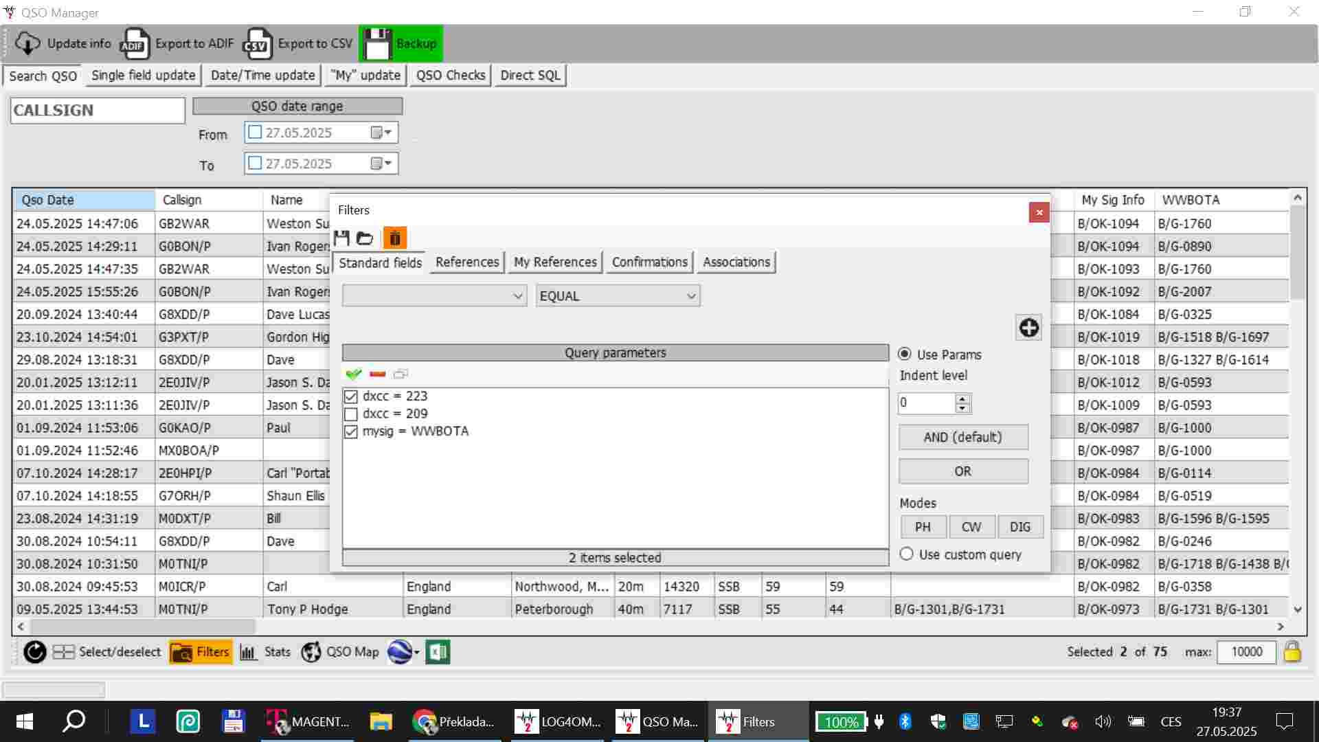

Re: QSO Filters
That's exactly it Terry, thanks for the guide. I've already managed to filter B2B QSOs between OK and G.
dxcc=223
mysig=WWBOTA
References - WWBOTA (empty)
Thanks again for the help and guide.
dxcc=223
mysig=WWBOTA
