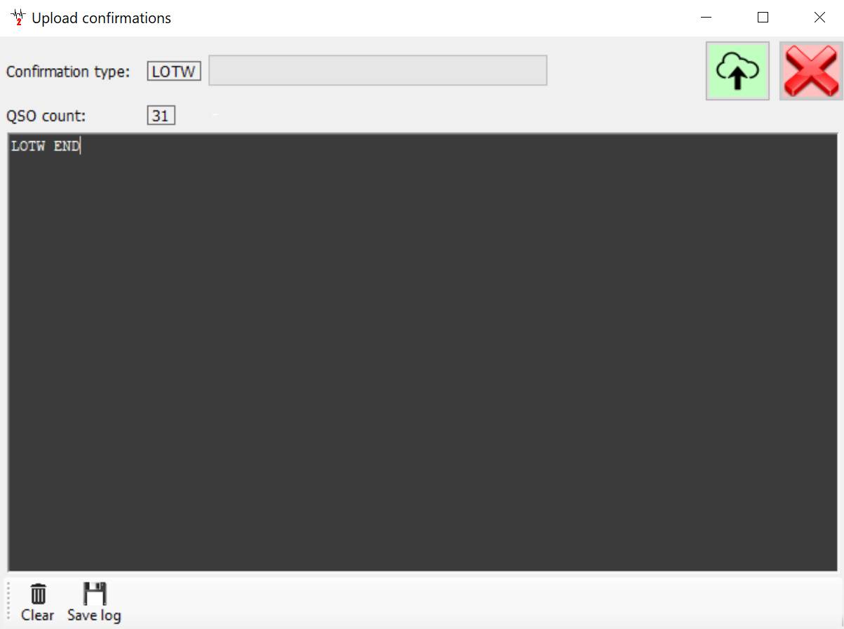

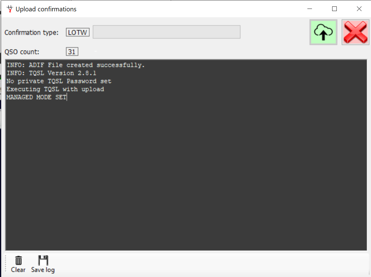

I switched over from HRD a few days ago. I'm using Log4OM version 2.36.1.0. When I try to upload my QSOs to LOTW using the QSL Manager i get the one of the following messages:
log4om lotw 2.PNG (96.11 KiB) Viewed 34 times
-or-
log4om lotw.PNG (52.22 KiB) Viewed 34 times
Since I've been using Log4OM I have not been able to upload to LOTW. I read through this this forum thread which is similiar to my issue and have tried the mentioned solutions with no luck.

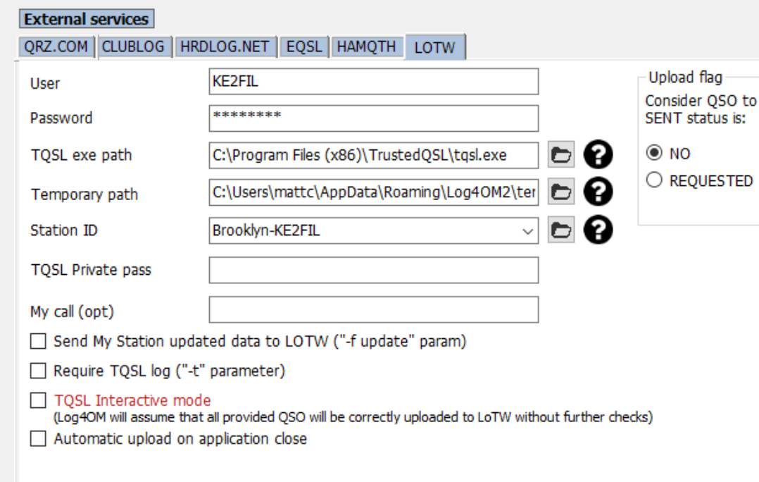

Here are my settings:
log4om lotw config.png (225.36 KiB) Viewed 34 times
I do not remember using a private password in the past. I was previously uploading my QSO's to LOTW in HRD without issue. My certificate expires in 2028. TQSL version: 2.8.1; Config version 11.32. I checked my log on LOTW and the last upload was from HRD. Log4OM uploads to QRZ properly. What can I check next?
