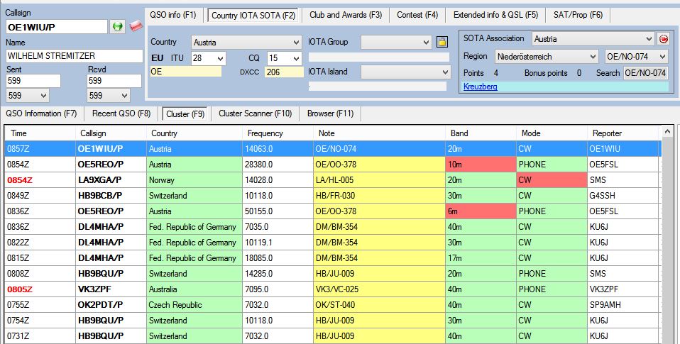

Release 1.21 includes a facility to use the SOTA cluster to view SOTA only spots
The current SOTA Cluster address is elgur.dtdns.net, port 7300 (elgur.dtdns.net:7300). - Check that in the Log4om cluster connection screen (Utilities/cluster) the check box “Cluster heartbeat enabled” is not checked. The SOTA MT do not want the 'Keep alive" system used by all regular logging software to be used with their cluster. The drawback is that should the cluster become disconnected there will be no Log4OM warning prompt, the cluster spots will just stop appearing.
There is a minimal login, after some blurb about the system users get a "login: " prompt where they type their callsign (This is automatically completed by the Log4om login script) This will timeout after 30secs with no response from the user and close the connection. After a callsign is sent, the cluster responds with the last 25 spots it has seen.
After that the system will send cluster spots like an ordinary cluster. However there is no input facility, it is a read-only cluster, i.e. you can see what is being spotted but you cannot send spots to the SOTA cluster.
If you have enabled "Automatic cluster recognition" in the Log4om Options/Cat & Cluster" tab then if you click a SOTA cluster spot the SOTA association, region, summit ref. and summit name are automatically entered into the input fields together with of course all of the regular QSO data like call sign etc. This makes SOTA logging, as either and activator or chaser, extremely easy.

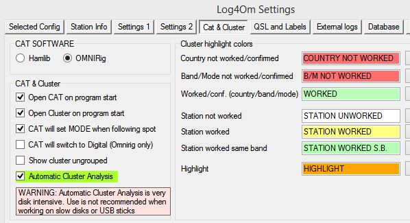

What a great feature ...have just downloaded the latest version ...well done! I have just set the sota spots feature up and can see the sota spots. However when I double click an entry all of the information except the summit populates the fields. In other words I still have to go back and add the summit reference into the sota search box. Perhaps I have done something wrong?

John,
You must check the "Automatic cluster analysis" box in the Options/Cat & Cluster tab as below
This also provides autofill of other data from a cluster like some awards etc
Re: SOTA Cluster
Thanks Terry ...that fixed it. Great feature.
