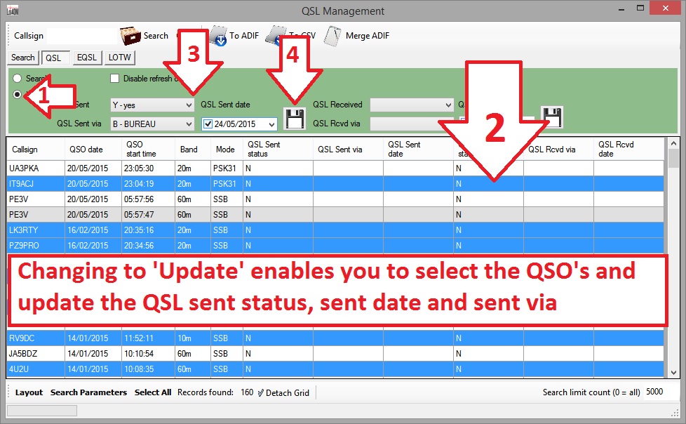

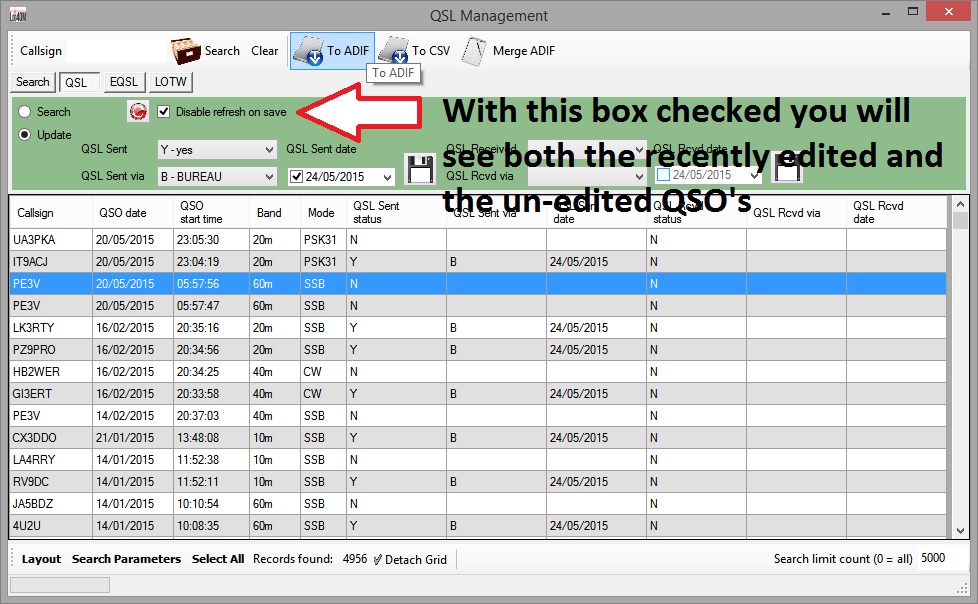

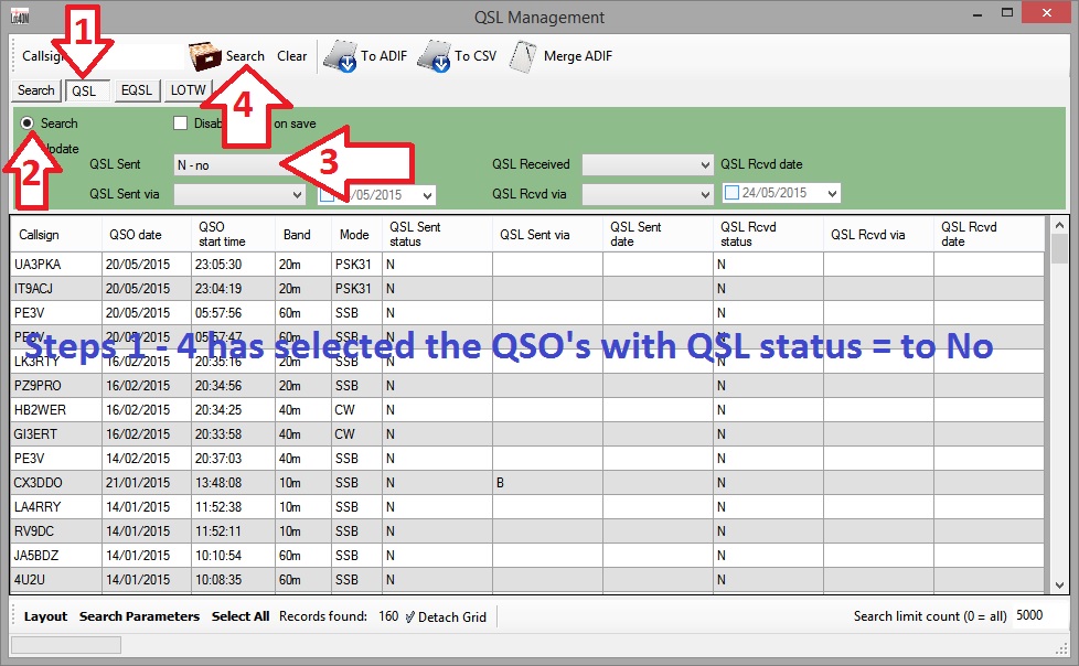

Re: Disable refresh on save
I understand that you dislike the label print routine in Log4om which would have automatically updated the QSL sent status, date and via information so as you are manually writing cards this is the procedure for updating - You don't need to double click a QSO and edit
Follow the steps below.........

If you leave the 'Disable refresh on save' unchecked then you will just see the remaining QSO's where the QSL received status was No
