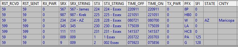

Last weekend I used the newest version of log4OM to log the 7QP contest. Worked very nicely for it. Problem found is that when viewing the log in contest mode everything looks great. Showing the exchange right and all other information. When this log is exported to ADIF the exchange is lost. Some of the contact times are missing and instead of state it just puts USA.
Am I doing something wrong?

It would seem that you are doing something wrong because I just tested this in version 1.21.00 and all contest fields (SRX, SRX_STRING, STX, STX_STRING) are exported as are the state & county fields as shown in the ADIF export displayed below in ADIFMaster.
How exactly are you doing the ADIF export - Step by Step please

My apologies. Before replying to your post I downloaded Adif Master and low and behold there is all the info. Its there. Must be in the conversion to cabrillo that its being lost. can you recommend a good conversion program?
