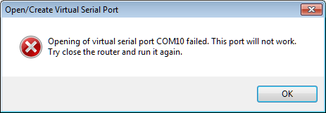

i know that this is NOT an L4O problem but i have problems to connect my microHAM CW Keyer after a new start of my PC.

After the first installation of microHam´s "USB Device Router" Software (actual version) all was working perfectly. Now i made a restart of the computer and the Router software gives me an error message (see attached picture). Then i deleted the virtual COM which was createtd by the router software, closed the software (also the pc) and try to create a new virtual COM. But always the same message as you can see in the attached pic.
Anybody here using this keyer, has it working and can tell me what´s going wrong on my side ???

I no longer have a microkeyer, but have encountered this type of problem before. What I suggest is you go into the Windows Control Panel, and under System, go into the Device Manager. Within Device Manager have a look at what COM ports are running. If you see COM 10 then right click on this entry and hit Uninstall button. Hopefully if you reboot your PC it will install a new virtual COM port for you.

thanks for the reply. I have used another way now. Completely uninstalling the USB device manager, after a restart i made a brandnew installaton and a.t. moment it works perfectly.
The Device manager in the windows system don´t have any COM Port installed when the microHAM usb device router software is inactive. I Think the biggest problem is that the USB Device manager from microHAM creates this port only when starting up. Would be better when this software creating the ports only 1 time if you install them. Will see what happens in the next days. For now i have it back at work and also after a restart of the system no problems now.
A suggestion for users of the microHAM devices. Start the router software first before you use your favorite logger or contest logger. If you start the logger first he will not see the winkeyer com port. This port is only created if the microHAM device router software has been started.
