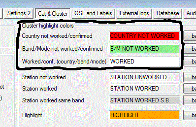

Thanks very much for your prompt reply.
My color scheme seems different (see attached below), but I understand your illustrated description you posted. That is how I would expect it to work. However, it doesn't work that way for some reason. I suspect something might have changed in the new 1.22 version, or I just simply never before paid close enough attention to notice.
If I have worked / have confirmed a certain MODE of a DXCC entity on one band, if that DXCC entity appears in the cluster on another band, the cluster highlight color will indicate unworked / unconfirmed MODE for that DXCC entity if I haven't worked / confirmed that MODE on that particular band.
It's not supposed to work that way. The MODE highlight colors should work independently of BAND highlight colors. I don't care if I don't have a particular DXCC entity confirmed on CW on all the bands as long as I have a CW confirmation at least on one band.

Nothing has changed in this respect in version 1.22 and I am using exactly the same version downloaded from the public web site so exactly the same as you haveVE3VEE wrote:My color scheme seems different (see attached below), but I understand your illustrated description you posted. That is how I would expect it to work. However, it doesn't work that way for some reason. I suspect something might have changed in the new 1.22 version, or I just simply never before paid close enough attention to notice.
Please don't get confused the highlight colours can either display the status of 'Worked' or 'Confirmed' depending on what button you have checked in the "Highlights" pane as shown below - My screenshots refer to the "Worked" statusIf I have worked / have confirmed a certain MODE of a DXCC entity on one band, if that DXCC entity appears in the cluster on another band, the cluster highlight color will indicate unworked / unconfirmed MODE for that DXCC entity if I haven't worked / confirmed that MODE on that particular band.
They do as demonstrated in my screen shotsIt's not supposed to work that way. The MODE highlight colors should work independently of BAND highlight colours
You might not care but many users chase band/mode slots for awards such as the CW DXCC or single band mixedI don't care if I don't have a particular DXCC entity confirmed on CW on all the bands as long as I have a CW confirmation at least on one band.
Have you checked that you don't have the wrong "Highlights" filter button selected as in the image above?

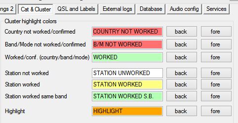

You might find it easier if you customised the cluster highlight colours with a more distinct difference as I have done, see image below.

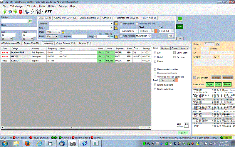

This in accordance with your highlight settings this indicates that you have NOT WORKED THIS COUNTRY on this band or this modeVE3VEE wrote:To better illustrate the issue, please see this picture. I do not work 17m so the cluster colors correctly highlight unworked/unconfirmed 17m (green color in my case)
The country column for those entries is white indicating that the country has been worked (Background White) on another band/modeHowever, I have worked/confirmed the three DXCC entities shown in the cluster on all modes (on other bands) yet the cluster highlights them to me as MODE UNWORKED/UNCONFIRMED (my default worked/comf. color is white).
The green highlight in the band and mode fields indicates as stated above that you have not worked the country on this band in this mode
This has been the way the cluster highlights were designed fro way back in version 1.11

As shown in my original screen shots this is correct just substitute white for green and you will understand that if an entity has been worked on the same band and mode it should, in your case show Country, Band and mode a white, or in my case as green.VE3VEE wrote:As it is now, in version 1.22, the only time the cluster "highlighs" (white color in my case) a MODE as worked/confirmed is when a particular DXCC entity has been worked/confirmed on the MODE on the same band it currently is in the cluster. That's wrong. The MODE should be independent of the BAND.
This has remains as designed since version 1.11

Thanks for the explanation. So the MODE column doesn't tell us weather we have worked/confirmed a particular MODE, but it refers just to the MODE ON THE SPOT BAND. Got it now!The green highlight in the band and mode fields indicates as stated above that you have not worked the country on this band in this mode
