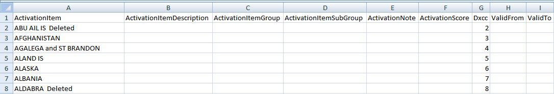

See below the header fields as in use todayg4pdf wrote:The csv import (from an Excel spreadsheet) appears to have worked there are problems now (I believe) as program development has moved on ...
the "Rare One" Activation Note does not appear, and if dates are added to 'ValidFrom' and 'ValidTo' columns, these don't appear either.
Can we please have on the Forum a small fully populated spreadsheet example of Award references that will import correctly when converted to a CSV format.
ActivationItem,ActivationItemDescription,ActivationItemGroup,ActivationItemSubGroup,ActivationNote,ActivationScore,Dxcc,ValidFrom,ValidTo
Here is a simple spreadsheet that I used to check how many countries I have worked on 60 meters
The valid from and to columns don't require completing it the from and to dates are the same for every entry, just use the from and to dates on the first tab of the manager.
Yes it is Windows only normal .csv file, I use Excel to arrange the data then save as a csvI'm assuming that on with a Windows-based OS, .CSV (MS-DOS) is the correct choice for export from Excel.
