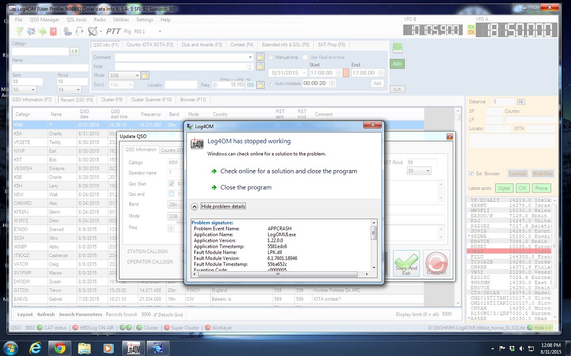

Terry, I'm having the same issue also. I've un-installed 1.22 and re-installed. Still have the problem. I type in either the address box or the notes box and the first key stroke crashes Log4. Didn't have this issue till 1.22. I can paste text into these boxes..just can't type into them.
I attached a screenshot of the error when it crashes.
- log4om crash when typing.jpg (249.5 KiB) Viewed 6691 times
