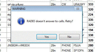

When I turn my TS-480 off, within about 15 seconds LOG4OM gives me the following warning:

Ok, I think the CAT msg is coming from Hamlib. Omnirig does not issue such a msg if the rig is off or CAT is interrupted for some reason. So you might give Omnirig another try. I like OmniRig because it allows a number of applications to share the same cat connection as long as they are compatible with Omnirig. For instance, I run Band Master along with Log4OM and they get along fine, both using Omnirig to handle the cat connection.
