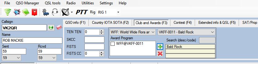

Would it be possible to add a WWFF, parks and peaks tab similar to the SOTA tab.
Your thoughts please.
Cheers:
Rob

Very Informative great for people chasing wwff stations worked however I was suggesting a new tab/field to be added for those activating parks, just the same as the fields MY SOTA ref, and MY IOTA ref. I'm using the SOTA field and it works great. Just did not see where I could add information for the park I activated. Did I miss something in the instructions.

The problem is Rob where do we stop adding tabs?VK2QR wrote:Thanks Terry
Cheers:
Rob
Arguably WWFF is not as popular as some other awards so which deserve tabs and which don't?
We have about 78 special awards, and more being added daily, that are similar to and as important as WWFF, we cant have a tab for all of them and if we did then perhaps we should have tabs for the DXCC awards because they are far more popular!
You see the problem?
IOTA and SOTA are different to the normal awards, requiring specific criteria and handling, they are also very popular, this is why we tabbed those two award schemes.
Re: WWFF
Terry
Yes I can see the problem, I understand regarding the other award programs, You have added the IOTA and SOTA fields because they are popular and different in the way they are managed, I believe the WWFF fits into the same category of popularity and management requirements especially for activators, very similar to SOTA. Obviously you need to draw the line somewhere. Maybe I will create my own custom award setup as demonstrated by your you tube video for the WWFF activating qualifications. The program is very flexible this way a credit to the writers thanks.

Sota and IOTA have dedicated fields in the ADIF protocol.
To handle those informations, the code should be integrated in a different way into the program.
SOTA and IOTA Handling could be done using "standard" award management, but some data should be extracted in a specific way and placed into the database in some dedicated fields to be exported in ADIF standard.
This is why we made a separate management.
SOTA has, also, a completely (in some manner "stupid") way to manage informations and references. This is a problem because it's completely different from any other standard we have seen in other awards, while WFF is using a more "regular" (and appreciated) standard that could be kept in the list of awards as well as any other award.
It's not a "first class/second class" choice. It's a pure technical implementation and constraints made by how the ADIF Group decided to manage IOTA and SOTA (and deliberately exclude all informations related to other awards from the protocol)
