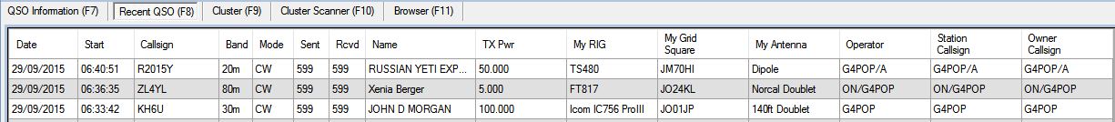

If the ADIF being imported contains the profile information (e.g. my city, my grid square etc.) then the appropriate fields will be filled with that information and can be displayed and filtered in Log4OM as shown below. (Three different profiles used for three different QSO's)
However if you are expecting Log4OM to automatically fill incomplete data in an imported ADIF, for example from N1MM, by using whatever current profile data you happen to be using then I think that would not work because the profile data that you have entered may not necessarily correspond to the actual location, station call, rig, antenna etc used for the competition in the incoming ADIF
