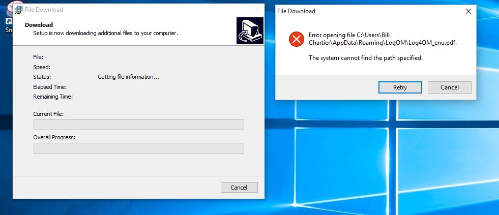

I am attempting to install "Log4OM_1_22_0.exe" on my computer. It is a Win 10 32 bit system I3 processor. I am using administrator privileges by right clicking on the exe file name and selecting "Run as an Administrator". Installation goes well until I get the message: Error opening file C:\Users\Bill Chart\AppData\Roaming\LogOM\Log4OM_enu.pdf. The system cannot find the path specified." I have attached a screen shot of the windows when this happens. Any suggestions? Thanks Bill N4iQ

Uncheck the box for downloading the user guide

Thank you Terry - that solved the problem. Can't wait to get Log40M going. I will migrating from software I have been using for over the past 30 years. I still like it but not a lot of support. Thanks for the quick reply - just seals my decision. bill N4iQ

Download is fixed in 1.23
