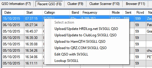

If you realise that the upload has failed because you have not had an internet connection just right click on the QSO and select 'Upload/Update to Clublog <Call sign>' as shown below
